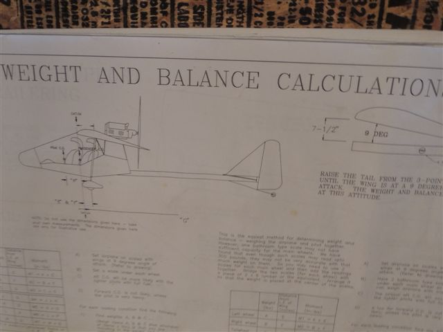

PostPosted: Sat Jun 22, 2013 8:11 am    Post subject: Re: Pre-Purchase Inspection, Firestar Reply with quote
Do a weight & Balance to make sure your aft CG Kolb is a safe flying machine. Many lighter Kolb Pilots need some nose ballast to be safe.
