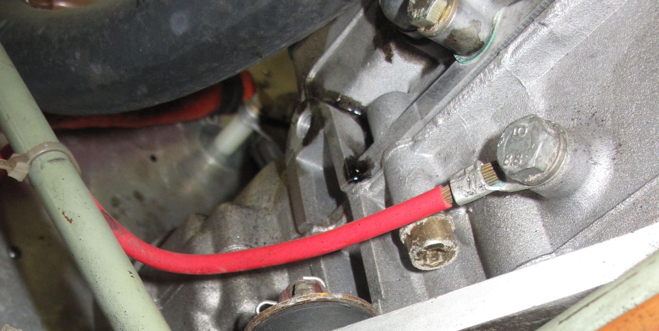

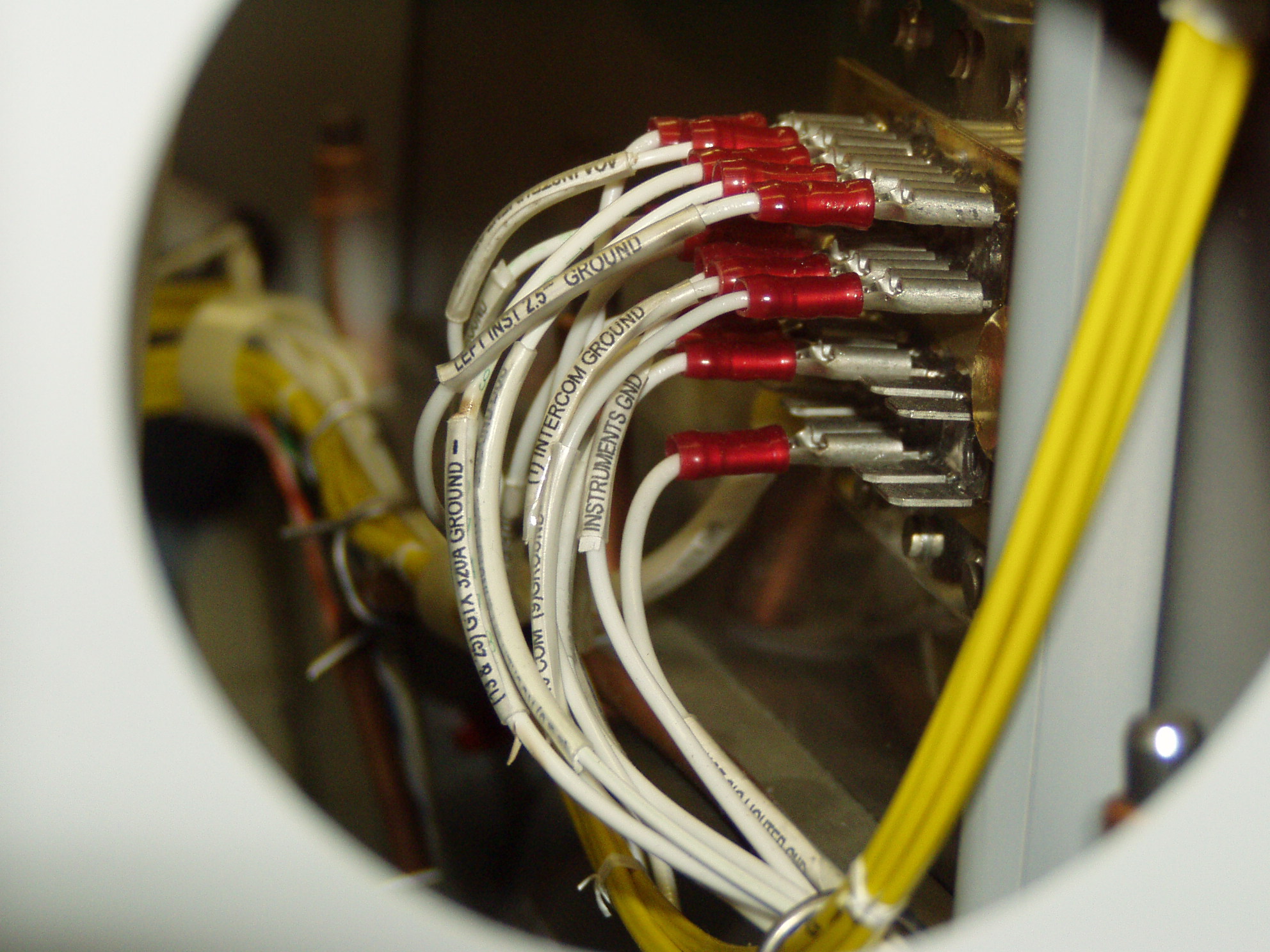

Hi,
My 582 brown wire is grounded to the engine. The ground wire from the Key West regulator is grounded to the frame. The engine is grounded to the frame with a braided strap – it needs to be heavy to handle the load when the starter is engaged. A lot of guys bring everything to a common ground on the aircraft. I did this in my RV-9A. See attached pictures for RV common ground and 582 ground strap.
All the best...
Joe
