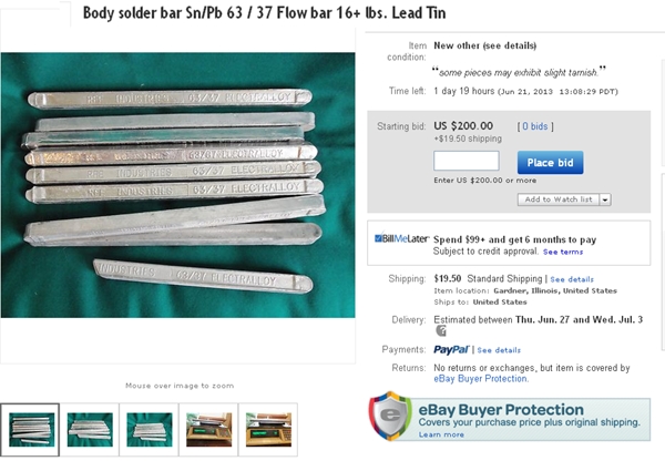

Found this interesting offer on eBay . . .
[img]cid:.0[/img]
The product offered is indeed supplied in cast bars
just like those used in body shops but if anyone would
purchased this item with the notion of doing body work,
they would be exceedingly disappointed.
Body solder alloys have a large 'plastic' range between
solid and liquid. I suspect an alloy like 40/60 would
be useful to a body shop. 63/37 has no plastic range.
About the time the user thought the solder was ready
to mold into the desired shape, it would melt and simply
fall on the floor.
This solder is, in fact, intended to charge the well
of liquid solder that is pumped over a 'wave' for soldering
electronics.
