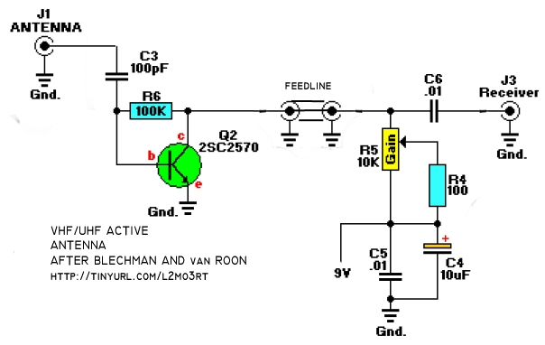

PostPosted: Sun Jun 16, 2013 7:21 am    Post subject: Hanger Antenna Reply with quote
At 07:18 AM 6/16/2013, you wrote:
Yes, the Ramsey AA7C looks as inconspicuous as I could get. I'll order one and give it an OPEVAL. Thanks
Mark
Okay. Some further considerations for the utility of
this product. It will come as a kit so assembly required.
It's designed to offer GAIN which may not be useful in
your situation.
Your task is to get energy from a short whisker antenna
(e-field probe) coupled into a low impedance feedline.
I suspect that signal strengths OUTSIDE your hangar are
adequate so adding gain brings some risks for overload
from local strong signals. Is there a tower or unicom
station on the field?
The kit is for an INDOOR accessory designed to sit
on a desk. It's BATTERY powered and designed to be
locally controlled by means of front panel switches
and knobs.
http://tinyurl.com/lrrylbk
Mounting this outside calls for hardening against
the elements. Sealed plastic or aluminum box?
The kit version has both HF and VHF/UHF capability
and all you need is VHF/UHF. Further, the ECB is
rather BIG for the small amount of electronics you
want to exploit. Here's Van Roon's schematic
trimmed down for VHF/UHF remote mounting.
[img]cid:.0[/img]
It looks like you could move R5, R4, C4, C5 and
C6 to the other end of the coax feedline. This would let
you run 9v up to the amplifier on the same coax that
brings the signals down.
This circuit could be built on a very tiny board to be
mounting inside a die-cast aluminum enclosure possibly
sealed with RTV.
There's only three components in the box on the roof.
The 2SC2570 is a leaded plastic device
The transistor, resistor and capacitor could probably
be 'spider webbed' between two BNC connectors in the
roof mounted box.
Mark
your situation.
and knobs.
<181d66a.jpg>
sealed with RTV.
roof mounted box.
