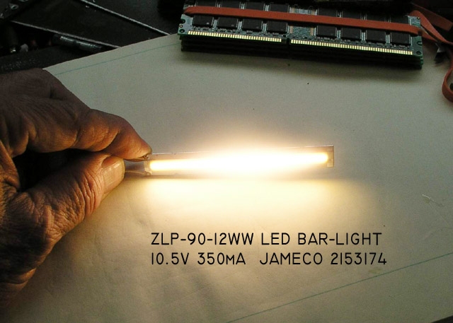

This is a strip array of led junctions . . . pretty tightly spaced.
Estimate .08" apart. The assembly is rated at 10.5v, 350 mA or
3.5 watts. Needless to say, the light output is considerable. This
picture was taken at room ambient light; output from the lamp assembly
stopped the camera way down.
The backplane is aluminum sheet. This looks like it would be used
for edge-lighting a display. Applications for our needs don't
immediately come to mind. This is best driven by a constant current
power supply like a BuckPuck or similar.
If anyone has an idea where this particular product would fill
the bill, drop me a note and I'll mail you this one.

How noisy is it. Can it be easily dimmed? I was thinking about it for instrument panel lighting, like the EL strips.
