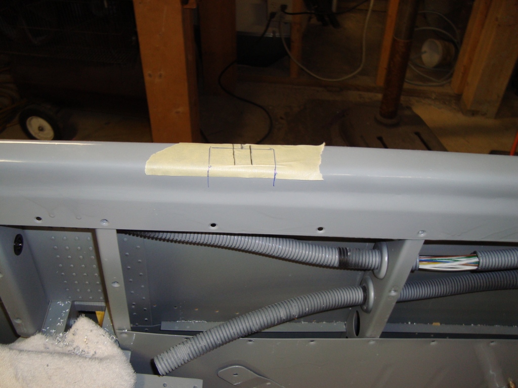

I ran my conduit straight forward like picture #8 on both sides (step
drill works nice here) and made a side panel cover out of some thin
aluminum I had laying around. Some PEM nuts/screws hold the side panel
on. I don't use the long angled piece at all.
Linn

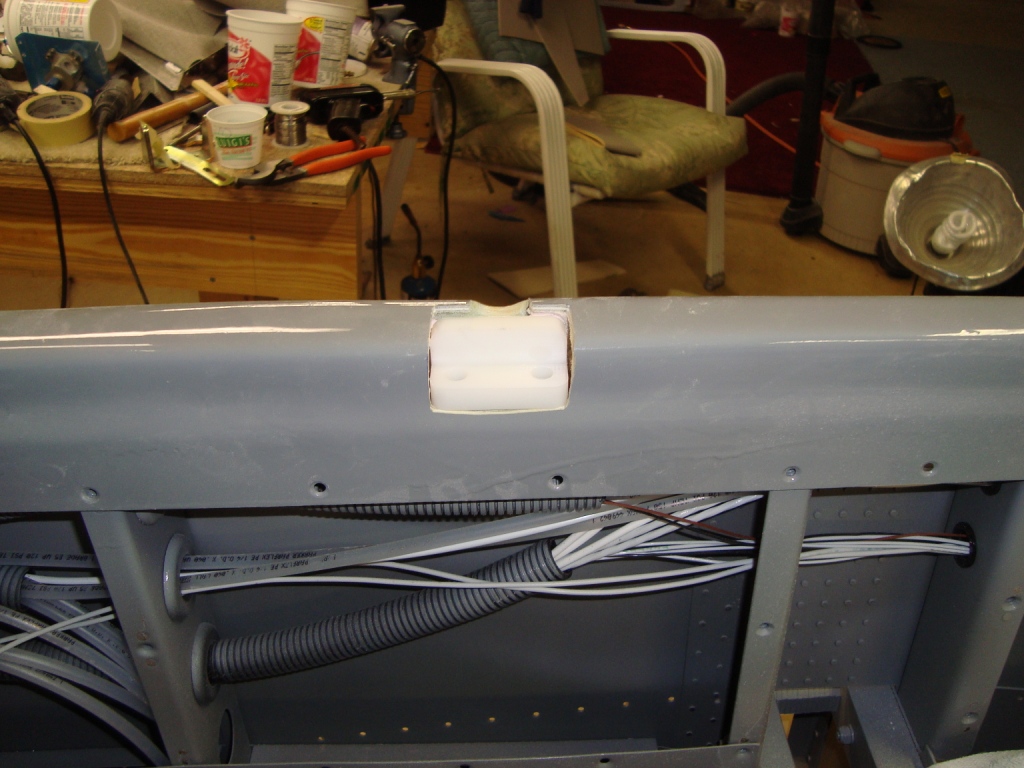

The attached photos are the only ones I can find that have more detail. The
conduit ends after it goes forward through the side rib lighting holes (the
ones where I installed the large grommets). Forward of that the runs just
use snap bushings like Van's has in his plans. I think I had to add one
additional hole on one side.

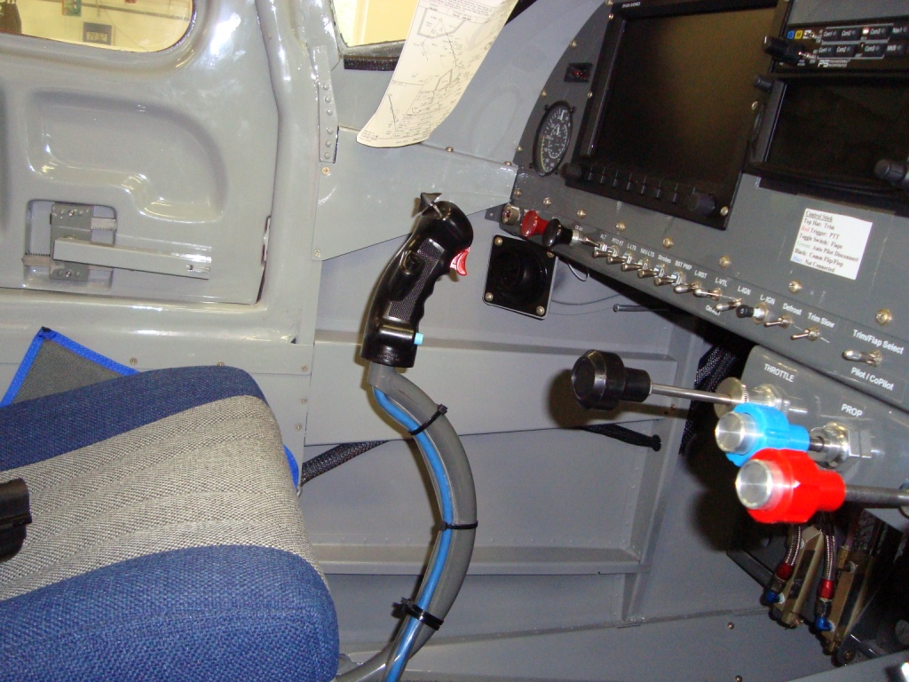

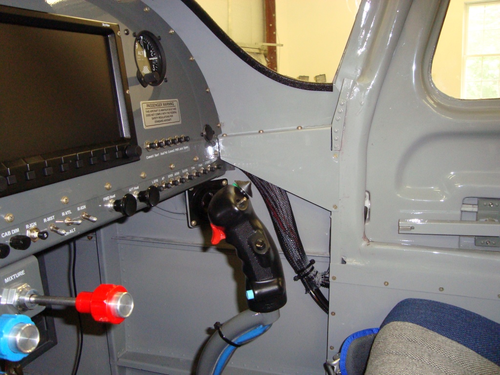

Note - there is no way to get all the wires and such past the panel bulkhead
just using the left side (with the supplied cover plate) per the planes. I
ran a 1" or so wire bundle up the inside of the last right side rib then
past the panel bulkhead in the side channel. I slightly enlarged the panel
notch that straddles the side channel for added clearance. I used some
plastic mesh conduit for this run. Most of it is hidden behind the little
side cover plate (photos #8 & #9).
