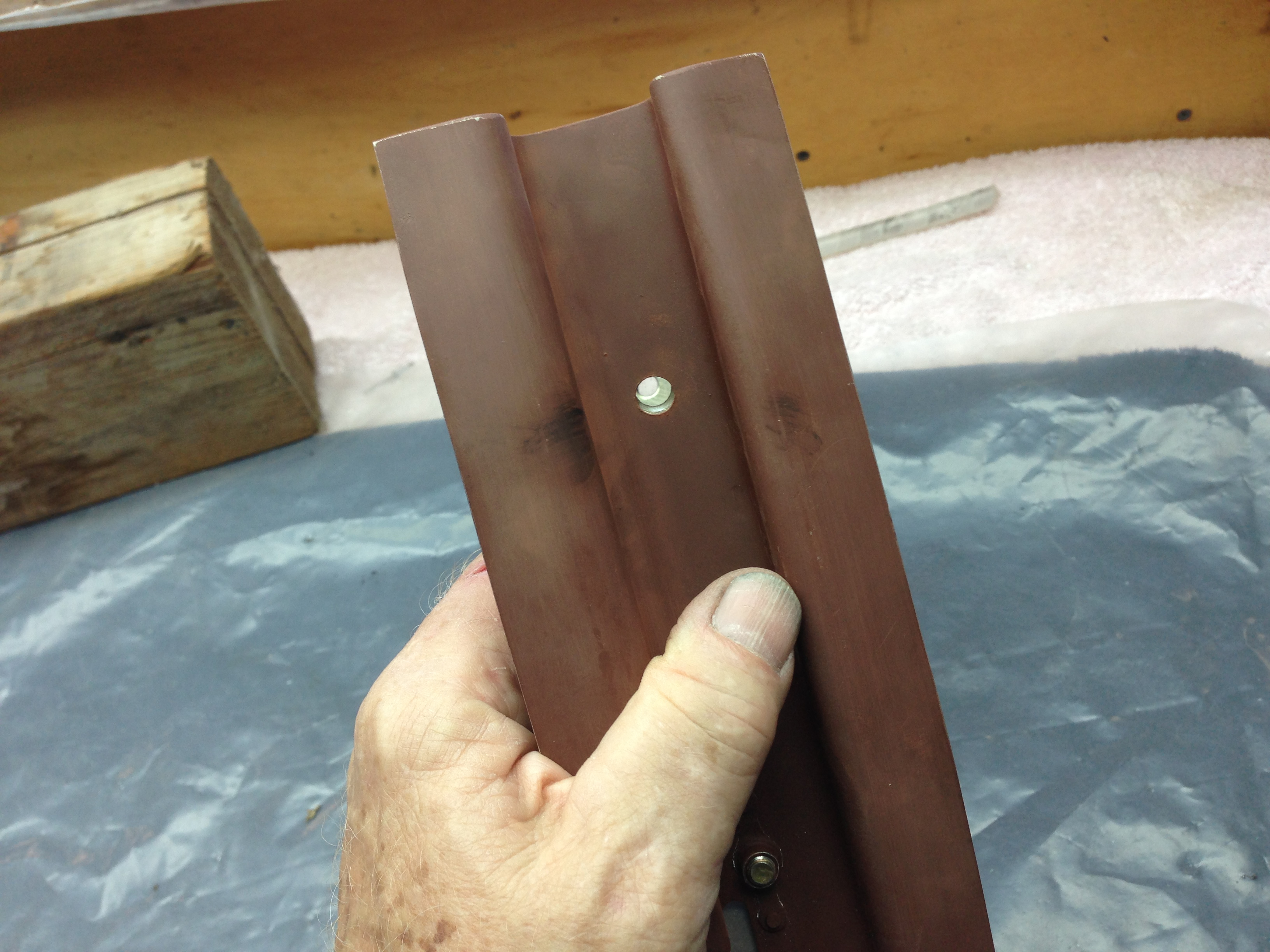

Just a heads up.
I got a new nose gear fork, wheel fairing, and brackets from Garner.
As is my usual routine, I preassembled everything first.
The brackets are drilled wrong.
When the bracket is bolted to the fork, the holes for the axle bolt are about .030 inches shy of where they should be.
As with all airplane parts . . . . trim to fit.
