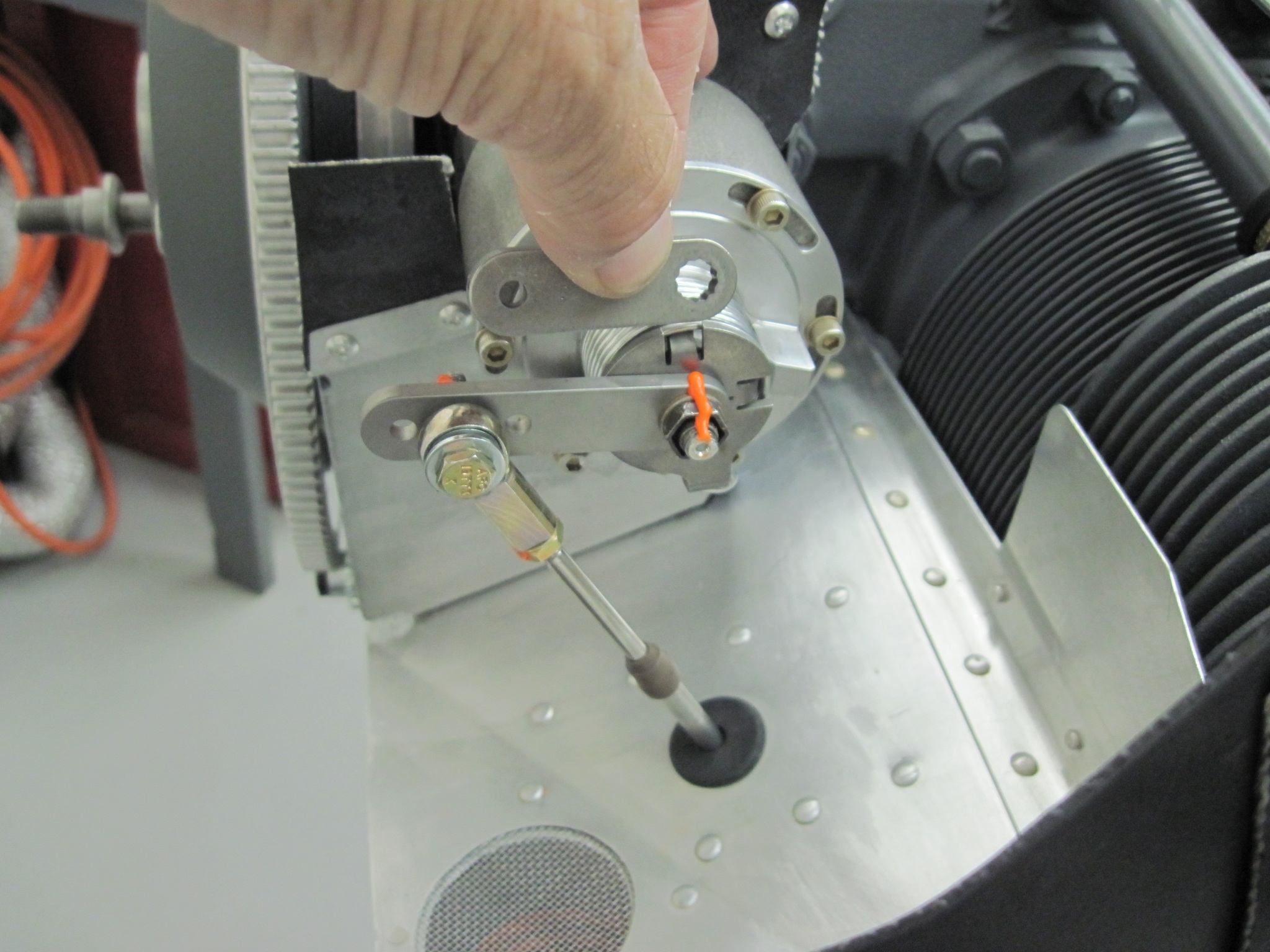

I have the Hartzell governor. You have to replace the arm if you are using the throttle quadrant. If you do not, you will get about half the travel on the quadrant, and half the leverage. Yes, it will work with the stock arm, but it looks unprofessional when used in conjunction with the quadrant.
I have not had any issues after 150 hours.
Bill

Where did you get the Hartzell governor replacement arm? I am using the standard one from Hartzell with the throttle quadrand and it works well but you are right. It only has half the travel on the quadrant. Leon

PostPosted: Wed Jun 12, 2013 5:22 pm    Post subject: Re: Hartzell Governor with C2YR Prop Reply with quote
I called Hartzell, and $27 later I had the part.
 Filesize:  651.44 KB
 Viewed:  8658 Time(s)
Bill

PostPosted: Wed Jun 12, 2013 5:43 pm    Post subject: Hartzell Governor with C2YR Prop Reply with quote
Hartzell part number 103568
