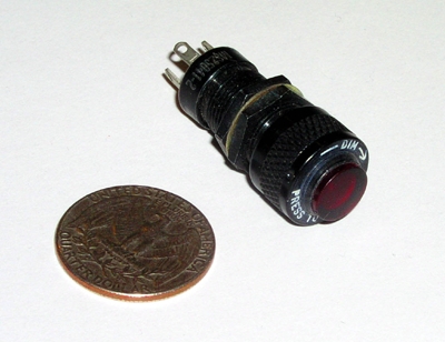

I'm working on an annunciator panel circuit that will have a push-to-test function and dimmer. No problem there. Smile
The challenge that I'm having is that some of the indicators will be powered by the line which drives the device (pitot heat, fuel pump, etc.) and others will be switched to ground.
I'd be fine if it weren't for the push-to-test function. Sad
Are these lamps incandescent or LED? Keep in mind that
the original application of lamps as annunciators for
important functions could not escape the fact that
a lamp's filament had a demonstrated service life which
was a tiny fraction of that for an airframe. It was prudent to
'test' each lamp before takeoff (or in flight should
a questionable condition be noted) to make sure that
the filament was intact and the lamp was CAPABLE of
doing its assigned task. Hence, legacy design philosophies
have birthed a plethora of press-to-test techniques.
[img]cid:.0[/img]
The fixture shown above has a press-to-test feature
built in . . . which does a fine job of testing the
lamp. But what drives the lamp? A canopy open warning
switch, an low oil pressure switch, low voltage warning?
What confidence is gained for system performance knowing
that the lamp is good when the device driving that lamp
is subject to its own, possibly hidden failures?
PTT for lamps made sense when lamps had an MTBF that
was a fraction of that for the constellation of
other devices in the airplane. With LED annunciators,
the philosophy putting dip-sticks into system
functionality in pre-flight are changed.
Low oil pressure should be illuminated before the
engine is started. The canopy unlocked light can
be 'tested' by observing the condition of the light
after the master switch is on but before the canopy
is locked. Low volts light will be illuminated any
time the master is on but engine not running.
In other words, the greatest confidence in assessing
system integrity calls for and end-to-end testing
of the annunciated condition. This philosophy is
valid irrespective of the type of lamp used. Better
to poke a stick at the warning SENSOR and see
that it lights the lamp than to push a button that
lights all lamps thus encouraging you to believe that
all is right with the universe.
So before you spend $time$ and panel space crafting
a PTT system, see if you can figure out a way to build
end-to-end, check list functionality testing into all
the annunciated conditions before taking the active
for departure.

This will be a backlit panel using LEDs (Green, Red or Amber).
I see you point about the reliability of LEDs versus incandescent bulbs and that makes perfect sense.
It just seems like every panel I've seen (and I'm pretty sure some where LEDs) had a push-to-test switch. So I was just trying to follow (what I thought) was best practices.
