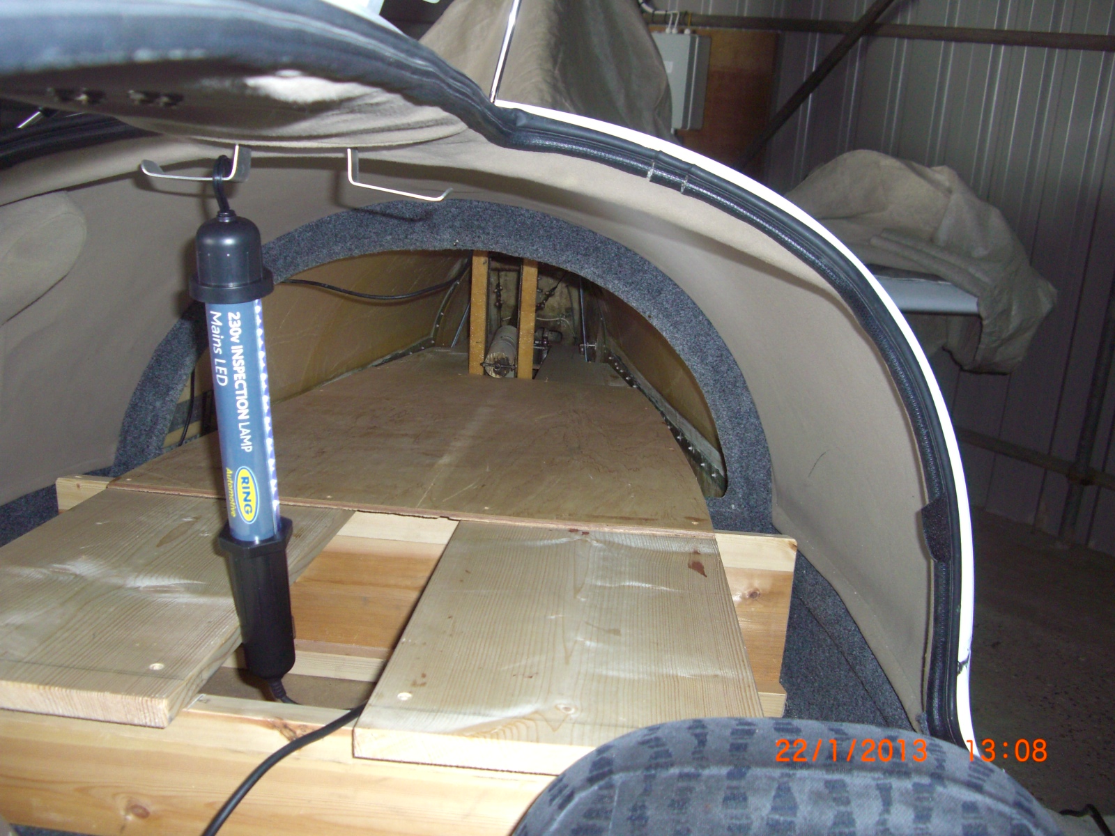

To do the job you can go down the tunnel or work through the rear 4” inspection hole, either way is difficult, but make sure you cover the edges of the inspection hole
with many layers of masking tap to prevent tearing your arm apart.

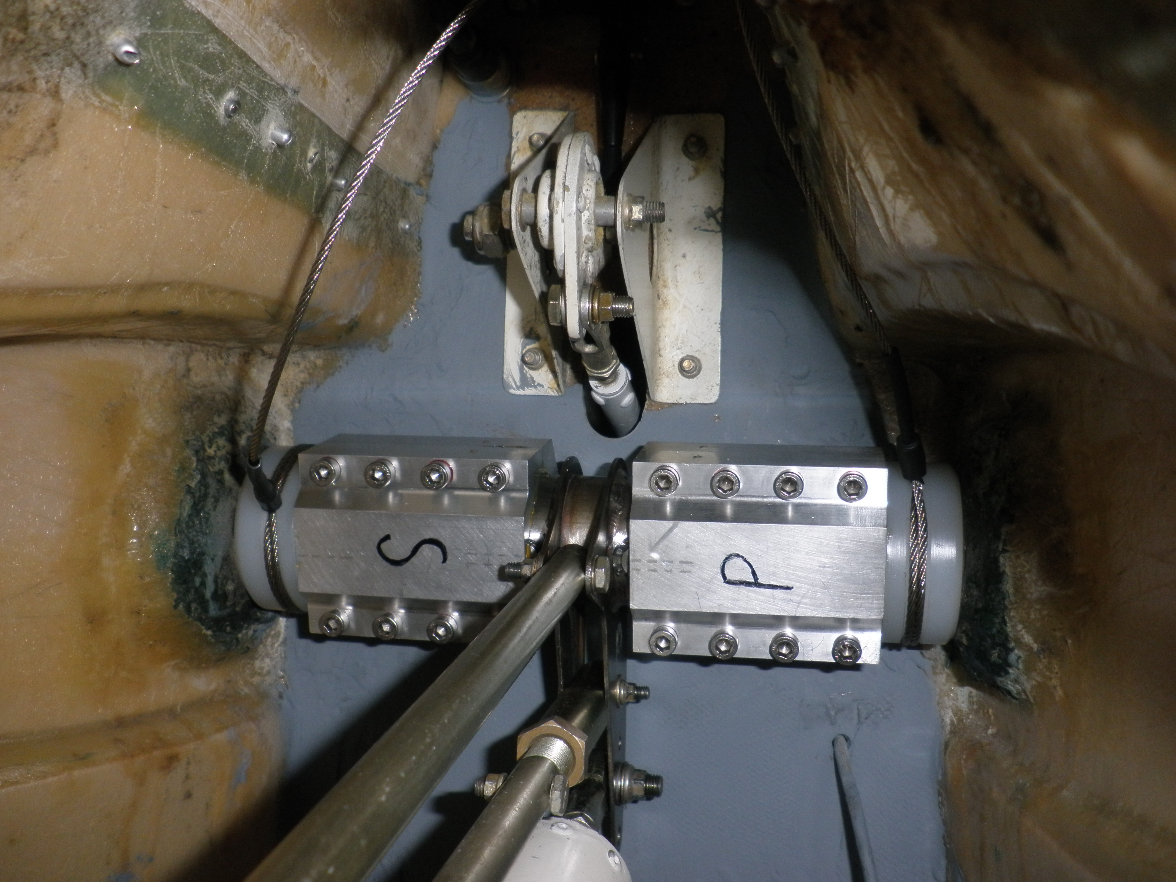

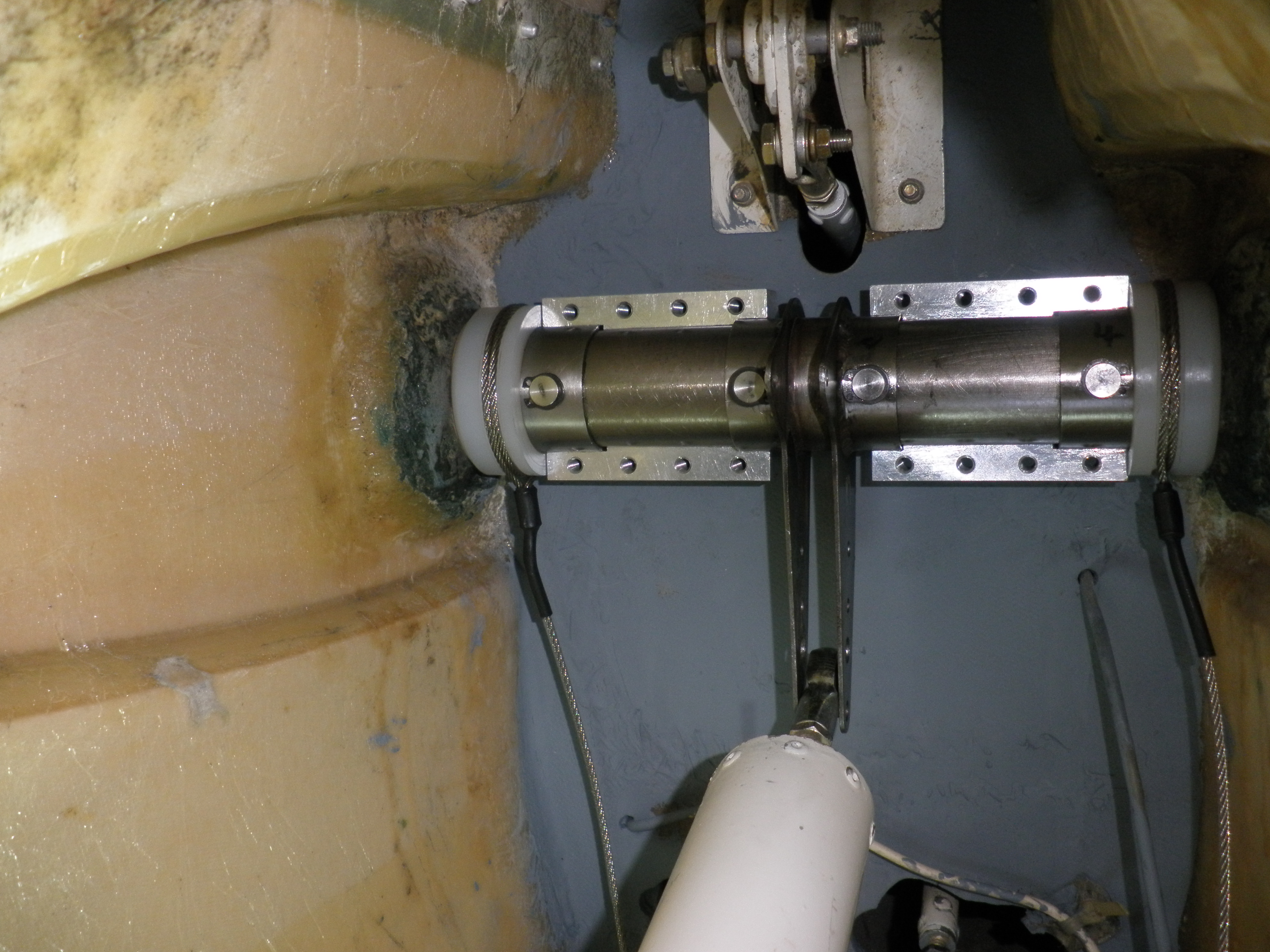

Pats clamps are individually made with fine tolerances to fit individual torque tube,
all the holes are machined round and new dowels made to fit,
the clamps are made to prevent these holes from wearing again,
its not a matter of just fitting clamps on worn dowels and holes,
even though Pat tests the clamps with the dowels removed to check for any movement.
You can see from the photo,s the clamps and the dowels cir clips, and retention wires partly fitted with the new thicker nylon spacers, all self explanatory,

When i look down the back from the D panel , my balance weight goes up and down without touching the Teflon in the tower,
and even if i say it myself it all looks really good and sturdy so i am pleased with the work done.
