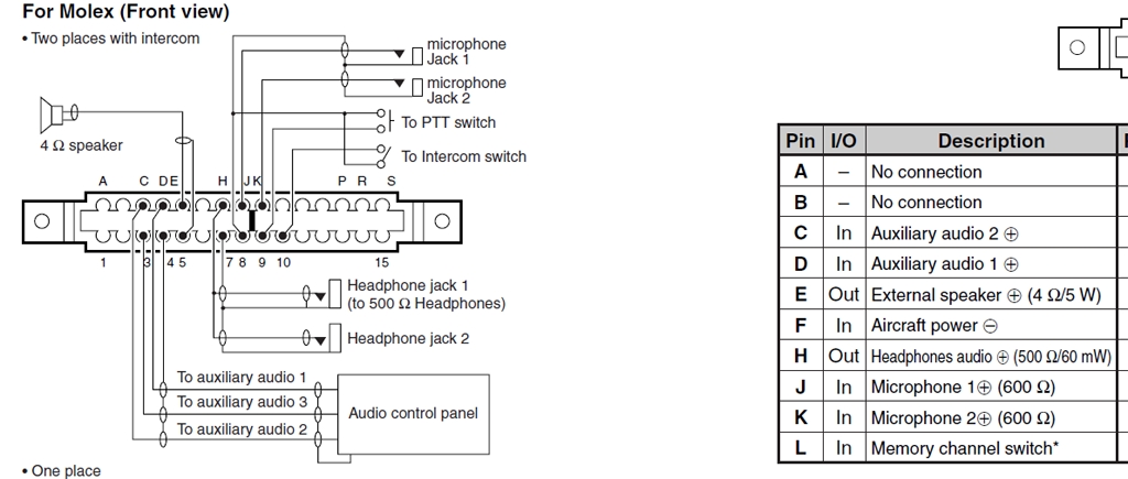

Hi Bob,
Sorry to be such a pain but I am at the point where looking at the instructions the diagrams do not show the complete terminals for the mic and headsets. They show the tip and the common as depicted by a blacked out triangle pointing down. But not the ring. What do I connect or what am I missing. A210.
I presume you're wrestling with this diagram . . . or siblings . . .
[img]cid:7.1.0.9.0.20130602191914.0037c9f8(at)aeroelectric.com.0[/img] [/b]
I note that NONE of their suggested drawings wires up
a jack for use with a hand-held microphone and PTT button.
ALL diagrams wire to ONLY the ring terminal for bringing
microphone audio into pins J and K. All PTT wiring is to
stick-mounted push-buttons. If you want to ADD the wire such
that PTT control comes in through the mic jack too, you simply
run it from jack-tip to pin 9. This can be in parallel with
any stick-mounted push-buttons.
 Filesize:  195.81 KB
 Viewed:  5885 Time(s)
barber_seville(at)msn.com

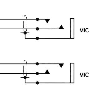

PostPosted: Mon Jun 03, 2013 9:49 am    Post subject: Icom Ic-A210 Reply with quote
Ok Bob,
I guess I didn't express myself correctly as I am having trouble with the symbiology involved with these devices. Is it correct to say that the symbol that looks like a little rectangle is the symbol for the "sleeve"? And is it correct that the symbol that looks like an inverted pyramid blackened is for the "ring"? And for clarification purposes in your drawing of the Microcom 760VHF transceiver is the symbol that looks like a Pyramid blackened the "tip" or PTT?

PostPosted: Mon Jun 03, 2013 9:32 pm    Post subject: Icom Ic-A210 Reply with quote
At 12:48 PM 6/3/2013, you wrote:
Ok Bob,
I'm not aware of any 'convention' for this symbol.
[img]cid:7.1.0.9.0.20130604002358.01e85fc8(at)aeroelectric.com.0[/img]
I've drawn it both ways when both mic (ring) and
PTT (tip) are connected. Your 'clue' is the relative
position of the two contacts. The one nearest the
mount would be sleeve; the one furthest away would be
the tip.
The problem you're wrestling with is ICOM's use
of the symbol wherein the UNUSED terminal is not
shown . . . so if only one is shown, which one
is it? You have to deduce tip from ring by tracing
where it's wired to the rest of the system. In my
earlier posting, I deduced that the contacts shown
were mic (ring) connections because they were wired
to mic audio terminals for the radio.
If I were making the drawing, I might use either
of the two versions shown but I would leave the
UNUSED terminal in place such that it's obvious
as to which one IS used.

PostPosted: Tue Jun 04, 2013 4:05 am    Post subject: Icom Ic-A210 Reply with quote
That does it, thanks Bob.
