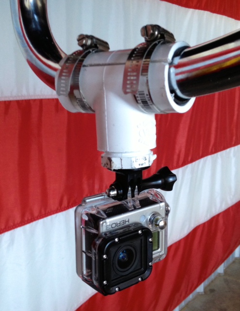

Craig here's my cheap PVC tail mount. Wing and turtle deck mounts follow.

I tried this GoPro location.... Not too good because each Time you roll, you puke a glass of oil on the camera Lens Smile

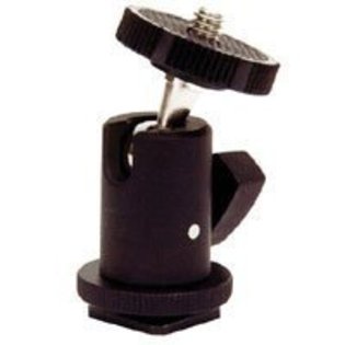

I have a contour HD camera and I took a standard small camera swivel mount similar to the one shown. On the female end I epoxied a 4 mm screw.
I can attach it anywhere there is a 4mm screw on the plane.I just use a rubber washer to protect the paint.

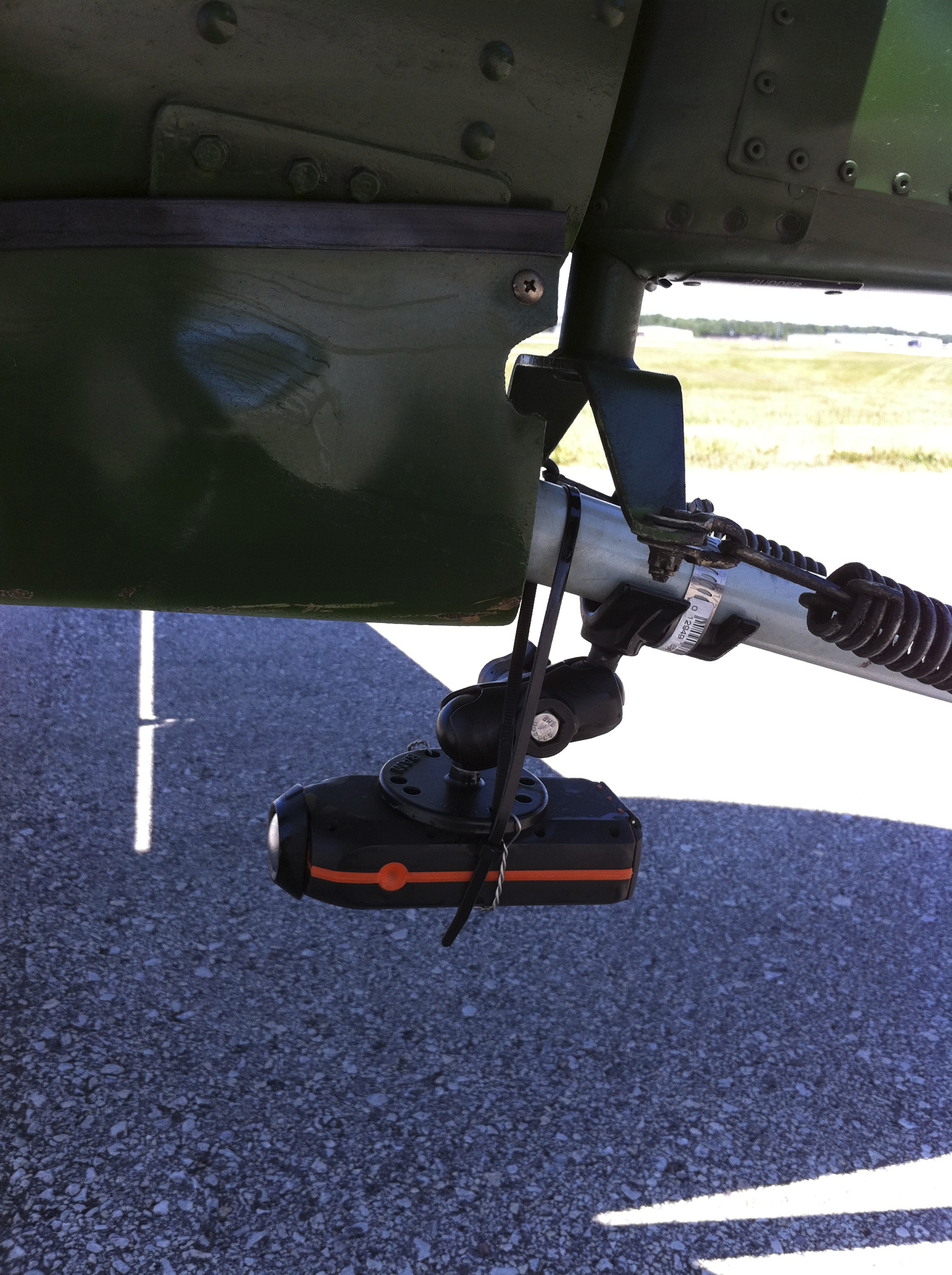

PostPosted: Sat Jun 08, 2013 6:45 pm    Post subject: External Camera mounts Reply with quote
I like the creative things people are using. Here is what I came up with. A ram mount. One end is an angled piece to use a hose clamp on a tubular structure of the plane. THe other end of the ram mount is threaded for a camera then safety wired and a zip tie back up. I use the HD 170 camera.
Attached is a sight picture example.
Only bad thing is if the smoke is on, the lens gets oily.
