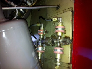

Cory this is the check valve setup for the pop off valve assembly for my YAK 50. Takes a little patience but the old YAK check valves can be removed from the pop off valve to rebuild the system. Since the pictures are on my iPad I will send them as singletons. Doug has a pop off valve manifold that will work also. You just have to mix and match. The metric male and female fittings are the same. The guts are not interchangable.
Doc
Sent from my iPad
