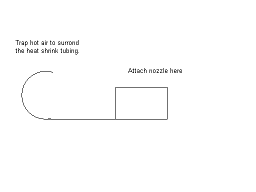

Another idea for the heat gun. Fabricate a deflector, imagine a U shape of about 3" dia and 3" wide of sheetmetal attached to the nozzle of the heat gun. This will dam the air from the gun so you don't have to rotate the wire while heat shrinking. See attached picture.
Heat Shrink Air Dam.
 Filesize:  576.05 KB
 Viewed:  1154 Time(s)

My heat gun came with this type of deflector, but it was much smaller. More
like a 1 to 1 1/2" diameter and width so you can get to wires in a tighter
place. I still like crimp sleeves and knife connectors. Bob U.
