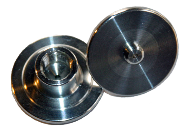

Couldn't agree more Kelly. I used the ones sold by Avery tool, I believe they are actually safe-air1. My air speeds are within a knot of being spot on.
 Filesize:  164.27 KB
 Viewed:  5840 Time(s)
