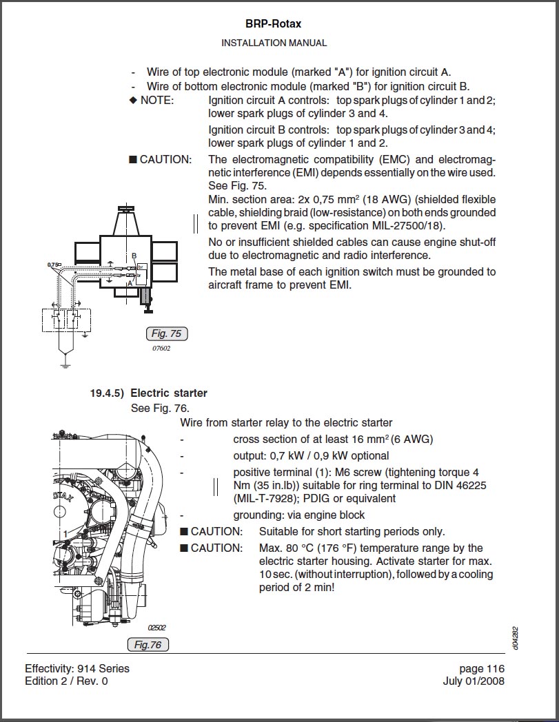

PostPosted: Mon May 20, 2013 5:28 pm    Post subject: Right mag drop and rought running on 914 Reply with quote
Jerry,
I thought it was as you said, but when I went to the 914 installation manual it showed different:
[img]cid:23F981DB-2DC9-460E-BA03-4A0CAE1C6E9D[/img]

PostPosted: Mon May 20, 2013 6:53 pm    Post subject: Right mag drop and rought running on 914 Reply with quote
Bob
I think they are out to confuse us!Smile
That diagram is for the 912 , don't  know why it's in that manual unless there is a footnote
Somewhere. I do know that my 914 top module, top plugs, bottom module, bottom plugs.
Guess we need a rotax guy to pipe in on this. Maybe can explain whats what!
Jerry

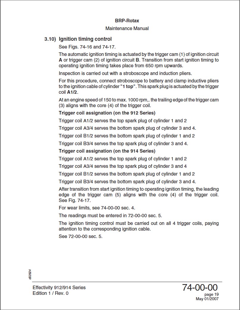

PostPosted: Tue May 21, 2013 3:40 am    Post subject: Right mag drop and rought running on 914 Reply with quote
Jerry,
I'm with you on that thought. I seem to remember from my Rotax 9xx class that the 912 was arranged like that but the 914 was simple A/top & B/Bottom. But the Rotax 914 current Installation manual shows different.
I've gone to the 912/914 Heavy Maintenance Manual, Ed. 1/ Rev. 0 date May 01/2007 Section 74-00-00 3.1.0) page 19:
[img]cid:D92C2BA8-655E-4DC4-B2AD-CFE586A2EC86[/img]
It shows the 914 as A/Top B/Bottom, which I believe is correct from what I remember from my school.
It looks like the 2008 revision of the Installation Manual may be incorrect.
I'll stop by the hanger some time today and dig up my copy of the original installation manual that came with my 914 and see what it says.

Hi All.
914. Has 4 Trigger Coils, on a horizontal mounting with 2 forward and 2 Aft.
The Top Module connects to the :
The 2 forward coils which are.
Trigger coil A1/2 serves the Top sparking plugs of cylinders 1 and 2
Trigger coil A3/4 serves the Top sparking plugs of cylinders 3 and 4
These are active when the Left Mag Switch is selected ON. engine running on top plugs.
I have colour coded the entire system from the LEFT MAG SWITCH. (L)ime/yellow.
The bottom module connects to the:
The 2 Aft coils are which are.
Trigger coil B1/2 serves the bottom sparking plugs of cylinders 1 and 2
Trigger coil B3/4 serves the bottom sparking plugs of cylinders 3 and 4
I have colour coded the entire system from the RIGHT MAG SWITCH. Red
“This is my 914”, Is they a standard mag switch wiring for this engine ?????.
Should L be the top plugs.?ie ignition system A. ??
now all I have got to do is fix the bloody thing
Alan

Alan,
I don't think there's a standard ignition switch arrangement.
I use two SPST switches. One for each ignition. Labeled them "Ignition" positioned over the two switches and A & B under each switch.
FWIW, I also use those colored switch lever covers on my switches. Red on Master, Blue on Ignition, Yellow on Starter, Green on fuel pump, White on lights.

Hi Bob.
My left mag switch fires the top plugs.
This is the 914,
On the 912 guess it does not matter as the left switch will fire a top and bottom pair.
I like the 914 arrangement as its more logical, ie
Left is the top and R is the bottom also you can eliminate it to either a problem in the top or bottom.
But i would like to know if other 914 the left mag switch fires the top plugs.
Alan
