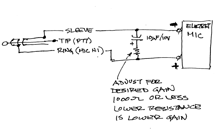

This off-the-shelf cartridge is a two-wire 'electret'
device that contains what ever electronics are necessary
to make it look like the legacy, radio-powered, aviation carbon
microphone.
You cannot reduce it's audio output with a potentiometer
in it's leadwires. While the pot would indeed adjust
the audio output FROM this device, it would adversely
affect the DC power being conducted TO the device.
You can place a resistor-capacitor network ACROSS the
microphone's leads thusly.
[img]cid:.0[/img]
Adjust the resistor value such that the microphone produces
a signal commensurate with others in your system. The
capacitor keeps the audio attenuator resistor from shunting
the DC power.
I'm guessing that a value in the 100 to 1000 ohm
range will prove satisfactory. You might temporarily
wire a potentiometer into the resistor's slot, adjust
the pot for desired gain, then measure with ohmmeter.
Substitute a fixed resistor of the appropriate value.

Hi Bob, Ken,
Many thanks for the very detailed explanation of the situation. A slap on the forehead is in order: I have covered up the front-facing side of the microphone, and thus might have disrupted the noise reduction mechanism. Interestingly, I mentioned this to the vendor, but it wasn't commented on in their response.
Let me first run tests with the front side uncovered. Then try your resistor-capacitor network solution, Bob. I really like the simplicity of the latter, just what I was hoping to hear from you!
I'll report back with further findings. Once this is figured out yet another DIY headset is going into production for the daughter. The pooch stays on Mutt Muffs as he rarely contributes anything useful to the conversation.
Thanks again!
Holger

A resistor and capacitor across the mic output could cause some
distortion, as the mic would then be loaded with a lower impedance than
just the radio input.
than just the radio input.
I've not found this to be the case. The artificial
lowering of radio input impedance has no non-linear
contributions. The amplifiers common to electret-
to-carbon interface are pretty high output impedance
to begin with and 'adjustment' of loading to bring
two microphones into agreement with each other is
not severe.
To be sure, having an adjustable mic cartridge is
the ideal condition, but when a non-adjustable
is what you have in hand, then a little 'jiggering'
of the gain is a low risk experiment.

Bob, if that's your experience with the actual circuits in common use,
then by all means it should be fine. The circuit I saw was a simple
emitter follower and not particularly high impedance, asking for more
audio current than it was happy with would be a problem. The problem is
not a nonlinear element, it's just that the circuit runs out of output
current. There are two common input impedances for aircraft audio
circuits, set by the value of the resistor feeding "bias" current to the
mic at either about 150 or about 600 ohms. Some amplified dynamic mics
have difficulty driving the 150 ohm variant without clipping.
And yes, the dynamic noise-canceling mics, usually the M101 or the M87,
are excellent. It takes 40 to 60 dB of gain to bring one of these to
carbon mic level however.

Hmmmm . . . I think the examples I encountered were single
transistor devices. This goes back a bit. I think I was
working with some of first Electro-Voice hand-held electret
mics and matching them to head sets of a brand I don't
even remember.
Emitter follower? Oh yeah, PNP upside down so that they'll
bias up with the radio's output.
I guess the only work around with passive components would
involve some series inductance to maintain the DC path
and paralleled with a series resistor/capacitor network
to set attenuation in the AC path.
A bit messier but perhaps doable. But yes, in these days
of every guy and his dog making/selling accessories, interface
conventions are not very 'standard'. Good thing we're working
with OBAM aircraft.
