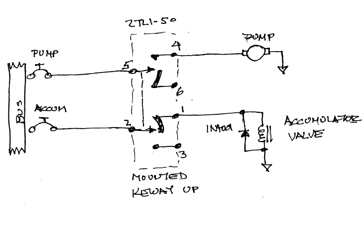

The pump and the valve are both simple on-off circuits. Is there a wiring diagram in your book to show how to wire this switch?

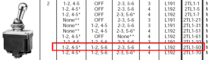

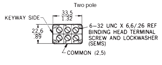

You need a 2TL1-50 toggle switch
http://tinyurl.com/azcswed
wired thusly:
