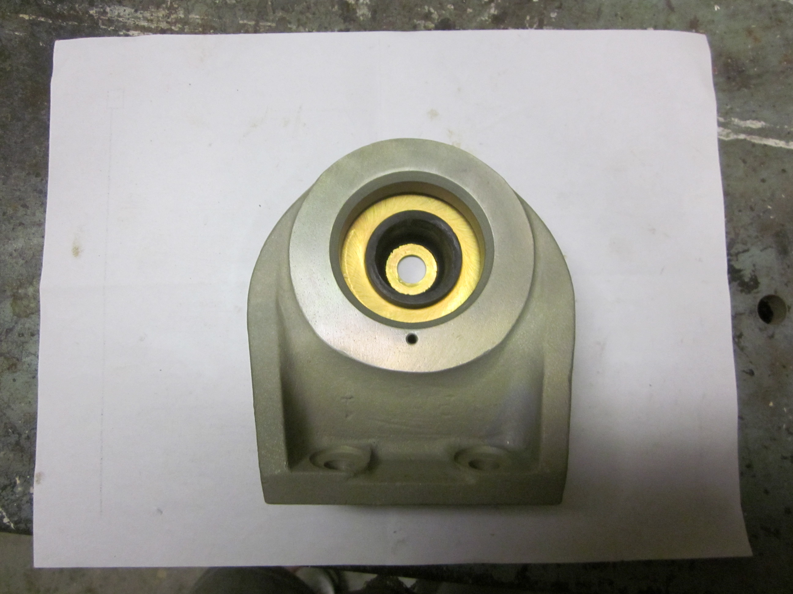

My engine mount ears have an inner diameter of ~2", while my dynafocal
mounts have outer diameters of ~1.375". I've attached a pic to illustrate.
I have an older narrow deck that I just had rebuilt...is it possible I need
to get engine mount ears with a smaller inner diameter?
Has anyone else seen this problem before?
Thanks.
Andy Johnson
Getting ready to mount the engine.

Yes, you need part number 70456 ears - they bolt on.
Bob
