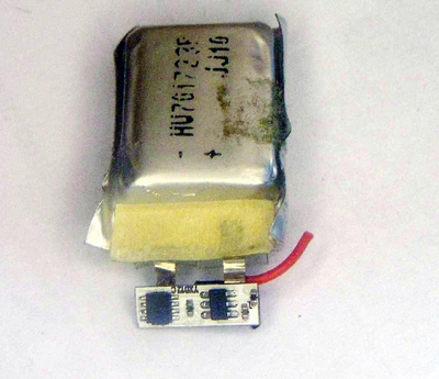

It seems the Aliant products are fitted with a battery
management system that takes care of housekeeping chores
unique to lithium batteries. That's a different ball
game. Even the little $3 Li-Ion batteries for my grandson's
helicopter is fitted with a BMS.
[img]cid:.0[/img]
Internal management of lithium battery vagaries
would go a LONG way toward making the product user
friendly and a drop-in-replacement for legacy
batteries.
