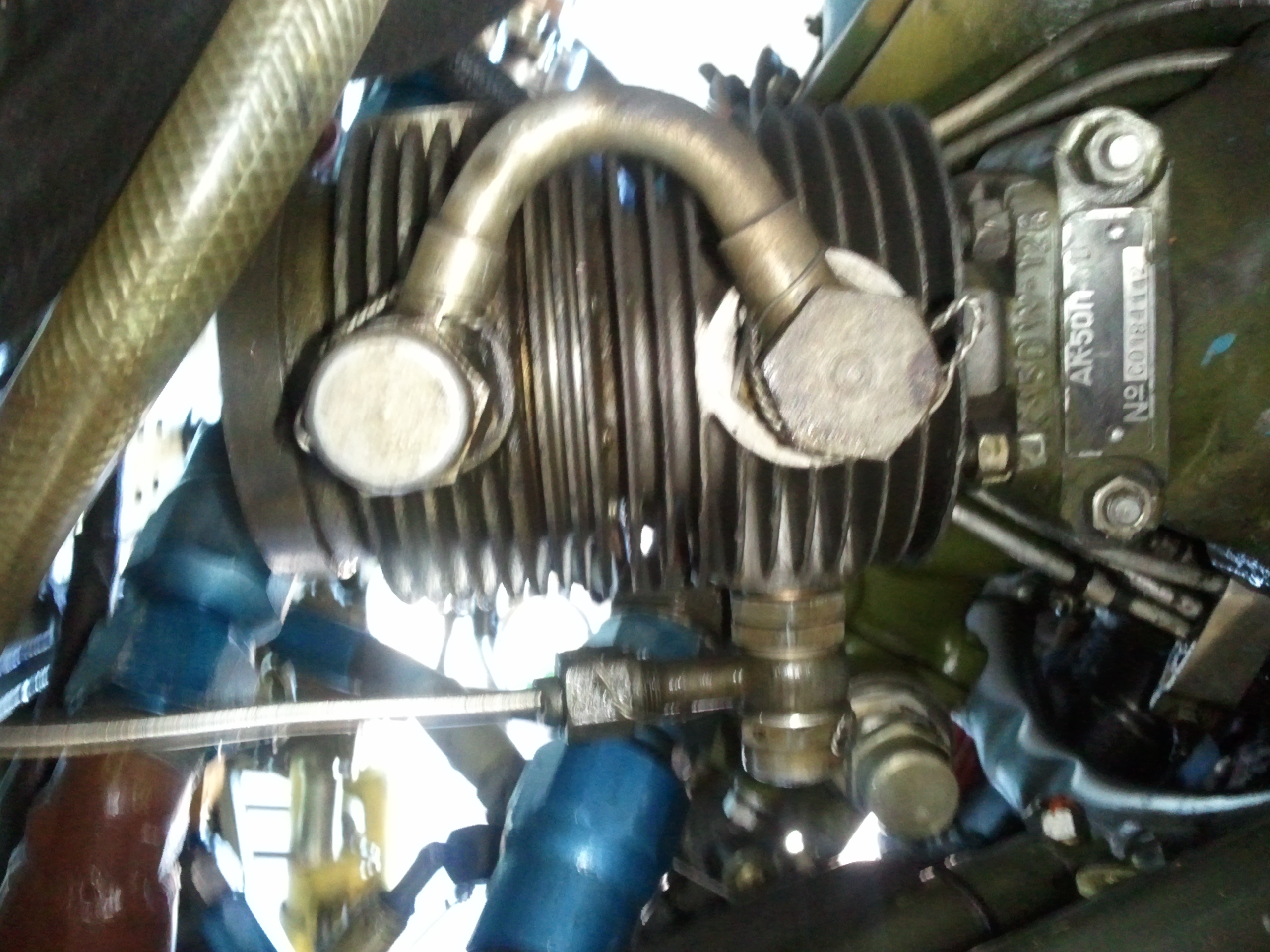

`And appearantly the AN2 is the same.  I fly with an AN2 compressor. About 4-5 inches longer and it appears there is a second compressor on top of what would be the normal M14 compressor. Works great. I can recharge an empty bottle at idle in about 5 minutes.

That's a sweet setup Larry.

Does anyone know if the AN2 compressor pulls significantly more horsepower
to run the higher volume output? I've seen the AN2 compressors on eBay
before and knew they would fit but didn't know if they pulled harder and
would cause a slightly higher fuel burn unless they were unloaded in flight.
Mark Davis
N44YK
threein60(at)yahoo.com
PostPosted: Fri May 10, 2013 10:17 am    Post subject: Compressor Reply with quote
I can just tell you from my experience.. I can unload mine in flight and i see virtually no difference in % or speed between the two. Because it is bigger it has to be clocked at a different angle which in my case required the oil hose from the screen to the pump to be made longer and re-routed. Love the extra air though...
