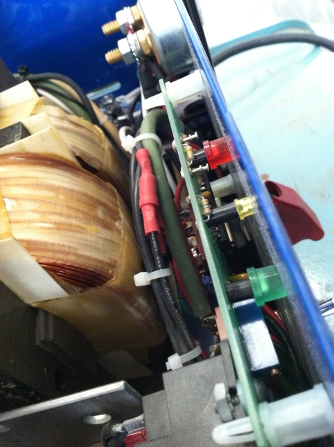

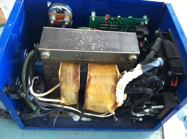

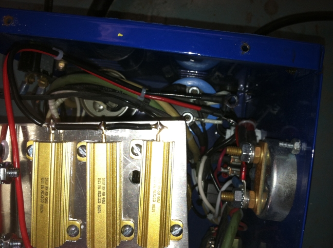

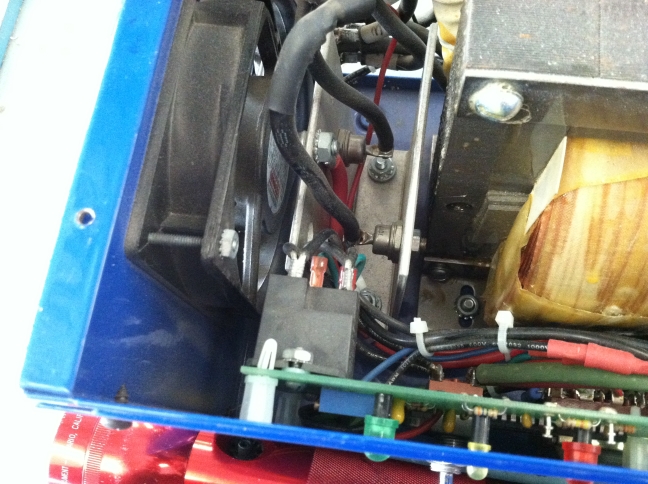

Here's a peek under the hood.  The gold resistors are the dropping kit.  They go in parallel with the big blue capacitor you can just see in the picture.  In this picture it's just sitting there, not connected.
Here's the dropping kit in action:

PostPosted: Fri May 10, 2013 1:24 pm    Post subject: Overactive Power Supply Reply with quote
At 12:04 PM 5/10/2013, you wrote:
Here's a peek under the hood. Â The gold
resistors are the dropping kit. Â They go in
see in the picture. Â In this picture it's just sitting there, not connected.
Yeah, the transformer with a big and little
windings is the giveaway. REALLY neat
technology for improving line and load
regulation of substantial loads (100 to
a couple thousand watts). Use to have
one in my darkroom to stabilize the enlarger
lamps. But not nearly accurate enough to
maintain optimal SVLA charging levels.
See: http://tinyurl.com/ckforvu
