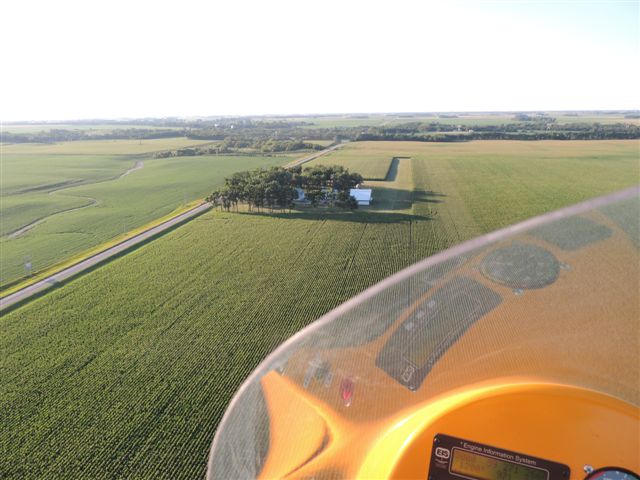

PostPosted: Tue Jun 25, 2013 6:01 am    Post subject: Re: Firestar II stall speed... Reply with quote
Success was not made possible by four leaf clovers or rabbits’ feet.
Practice!...Practice! ... Practice!
