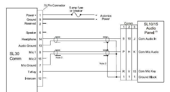

Not sure what you're referring to. Here's one of serveral
wiring diagrams gleaned from an SL-30 installation manual:
[img]cid:7.1.0.9.0.20130506135347.04cf1500(at)aeroelectric.com.0[/img]
In this case, I suspect that pins 13, 7 and 9 are
all common inside the SL-30 but only pin 9 is used
for attachment to ship's power ground. Pins 13 and
7 become a quasi-single point ground for the audio
system as it relates to the SL-30. Are there other
wiring diagrams that offer a more confusing picture?

So there it is, that 9 and 13 are grounds, running to the same AMP connector. This is what I was asking. Why are there 2 independent wires which end up going to the same AMP connector with 30 some pins on it that are all grounded together?
Then in the bottom diagram for a PS Engineering marker beacon, pin 9 is the power ground and pin 14 is the audio ground. So am I correct in assuming that they also end up at the same 30 some pin AMP connector – since the SL-30 pins for power ground and audio ground both end up there?
I cannot know the reasoning behind any particular
design decision unless it is specifically explained
in the manufacturer's documents. I can attest to the
my notion (shared by some) that many products miss
an opportunity to make a device easier to install
by making otherwise unneeded pins extra grounds.
This gives the installer an opportunity to neatly
terminate pigtails for shields on their own pin
in the connector. I have generated two widely
used, multiple connection grounding products. One
is the firewall ground bus sold by B&C, the other
is the panel/avionics ground bus offered on my
website. There are no specific assignments for
where connections are made on these products. My
architecture drawings feature ground symbols labeled
so as to suggest termination at a specific ground
bus . . . but not on any particular pin.
I am always pleased to see manufacturer's wiring
diagrams that offer dedicated ground pins for all wires
needing ground . . . but sometimes, it's simply
not possible to have plenty of grounds for all
contingencies.
There is nothing 'magic' about a proliferation
of grounds in any given connector.
