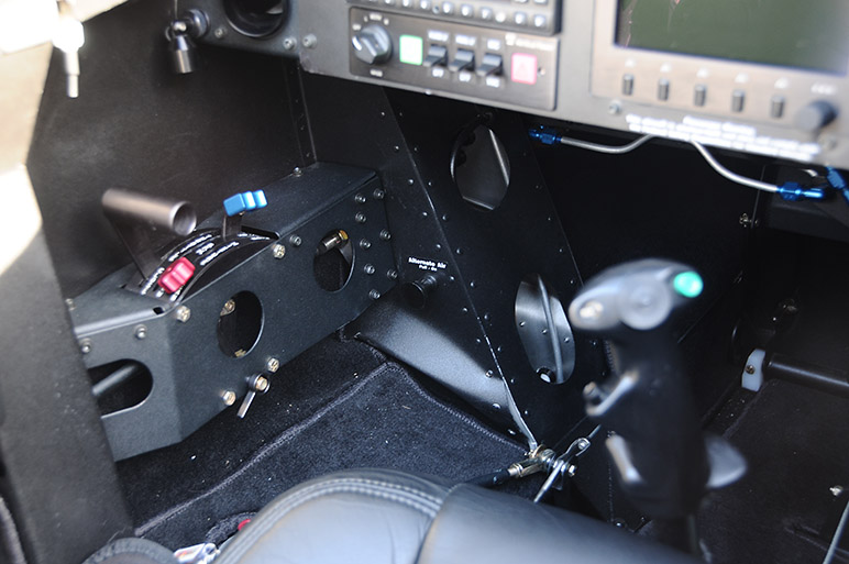

New to the list and I did not find the answer in the archives (RV10 builder now building an Cool.
Asked Van's about cutting out the area between the lower and middle lightening holes to improve access to that area, especially the attach bolts. KenS sent me the following reply this morning: "We know that some builders have done this, but we've never found the need. We have no engineering data one way or another on such a mod so we have no basis for advice."
Have any of the 8 builders done this modification and were you able to do any engineering analysis on resulting tower?
I plan to cover this area with a plate using plate nuts as was described in one of the forums.
Thanks - John Miller (Grumpy)

MANY of us have done this. 2nd RV8 with 200hrs on it with no issues. Go for it!

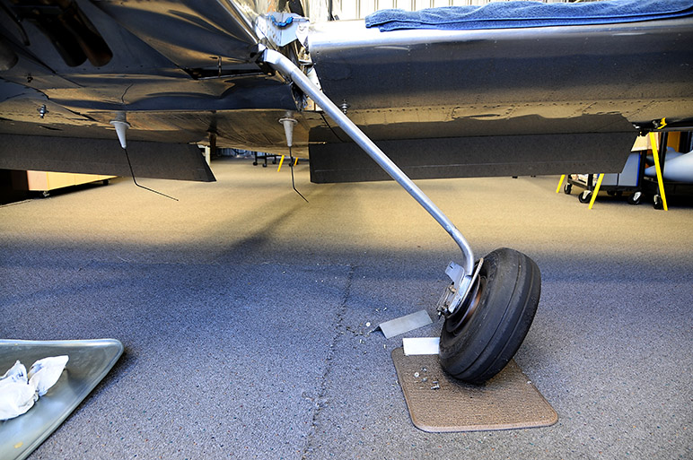

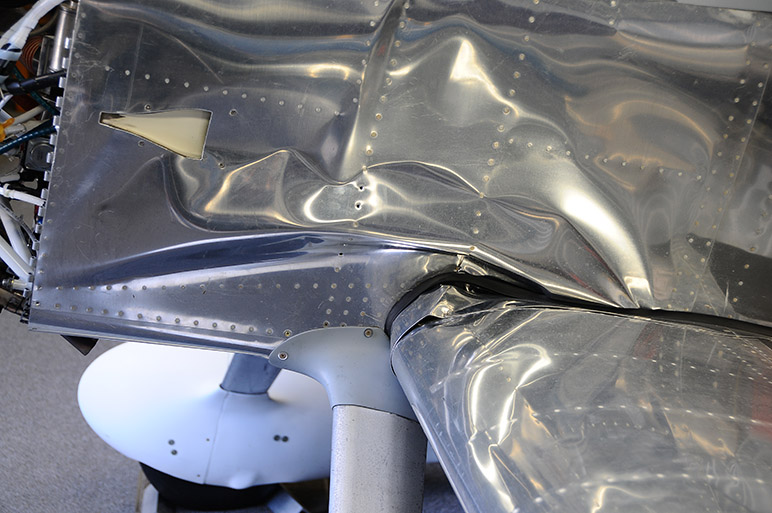

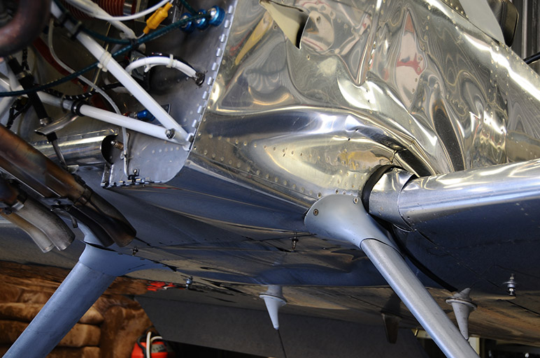

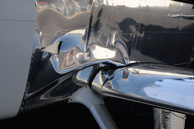

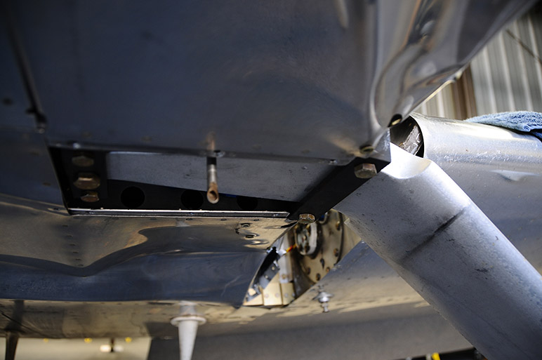

John,
I wouldn't do it. My experience has been that the gear towers in the -8 are a little underwhelming in terms of strength to begin with. The attached pictures show what happened to my RV-8 when I got it sideways during a high speed taxi incident. I had already landed and was making the turn off the runway onto the taxiway. I wish there was some engineered, accepted way of beefing up these gear towers. It would have been a lot less work than having to rebuild a whole new fuselage...

Al,
Did you do this on your first one as well?
Do I assume that you used the same aluminum as the tower?
Any tips on how you did it? I was thinking of a simple total cover plate, not just filling in like the VAF post by Dan Horton showed.

I did it the same way on 3 RV 8s. Just a simple cover plate. Send me your email and ill send you a picture.

Yes.
Just a .032 or .040 aluminum plate

I did it also but used 090 al for the cover with 8/32's
450 hours and close to 900 landings.
