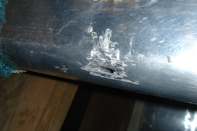

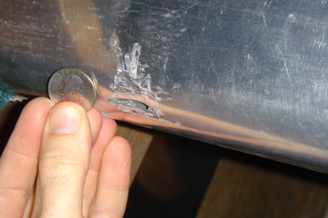

Here's a new one.
It's a long story, but we were transporting our RV-10 inside a 26' Penske rental truck. (it will fit, if you can believe it!)
Unfortunately, the crap that passes for roads in parts of this country bounced things around enough that one of our wings, held vertically in a cradle, shifted far enough that it contacted the fuselage step.  The result was a small hole, as illustrated in the attached photos.  More unfortunately, this is the fuel tank.
So what to do?  One current thought is to patch as follows:
1. Keeping wing vertical, put some fuel into the tank and alllow it to flow out the hole, flushing any aluminum dust out of inside of the tank.
2. Create a small patch just large enough to cover the hole.
3. Using "flush" blind rivets and some ProSeal, attach the patch over the hole.
The hole isn't really that big, so I'm not too concerned, structure-wise, as long as we can get a patch that is secure and not likely to leak.
Comments?  Ideas?

PostPosted: Sun Jun 11, 2006 6:11 pm    Post subject: Hole in wing Reply with quote
Darn that is a bad hole, I think that you should scrap both wings, send them here and then we will destroy them for you so that you don’t see the pain.  You will be able to build the new wings much faster and when we build our next 10 we shall be wings up so to speak.
Rick is much more experienced at patching things so he should be able to give experienced advice.

PostPosted: Sun Jun 11, 2006 6:33 pm    Post subject: Hole in wing Reply with quote
Ok, that’s just bad juju.  I have been making plans to move my project from TX to WI in a 26’ Penske truck with the wings in the cradle next to the fuselage.
I think your proseal blind rivet patch is the best idea.  Just use self sealing rivets.

PostPosted: Sun Jun 11, 2006 6:35 pm    Post subject: Hole in wing Reply with quote
I’d first make a hole in the rear bulkhead that Van’s sells the cover plate for.  Then, taking a piece of material, probably .040 like the wing skin, I would bend it to fit the contour of the wing, probably at least 3 inches in each direction beyond the hole, then match drill rivets with standard spacing and rivet the plate in, using proseal.  Then, you can putty the outside of the hole to take away the evidence to the unknowing eye, and screw or rivet on the backing plate that Van’s sells.  I wouldn’t put any fuel in the tank, but would clean out any chips with a vacuum and compressed air.  There shouldn’t be any chips from the hole, but from the rivet holes you make there will be.  That is a bummer of a place to have a hole.
The other option is to proseal a length of aluminum tubing into the hole from the inside, and run it in place of the vent line.  This would give you an added boost in case of engine pump and boost pump failure.

PostPosted: Sun Jun 11, 2006 7:15 pm    Post subject: Hole in wing Reply with quote
K.M.A. Bob,  Wink
Yeah other peoples mistakes. Patches are covered in AC 43.13-1B paragraph 4-58 Fig 4-16. I'm not going to elaborate, depending on the location to the leading edge, it may require stiffeners. Refer to the bible..I mean 43.13 to be sure your doing it right. But with a large enough circle patch and proseal, two rivet lines may be needed, it should be OK.

deruiteraircraftservices(
PostPosted: Mon Jun 12, 2006 12:46 am    Post subject: Hole in wing Reply with quote
hi,
repair as per Van's suggestions. Cut a hole big enough  in the rear baffle to pass your hand through with a fly cutter. Clean out the tank, deburr the inside of the damage properly, make a patch and dimple both skin and patch, plenty of proseal and rivet the patch on. Then cut a circular patch to cover the hole in the rear baffle.
Using access through the rear baffle is the Van's recommended procedure to rectify any leaks when testing the tanks for leaks after construction. This is in the manual.
However, I would the parts from Van's and build a new tank altogether as the profile of the tank might be a bit off because of the bouncing, it doesn't look as if it cut straight through on the first go. use the list on the Van's webstore.
