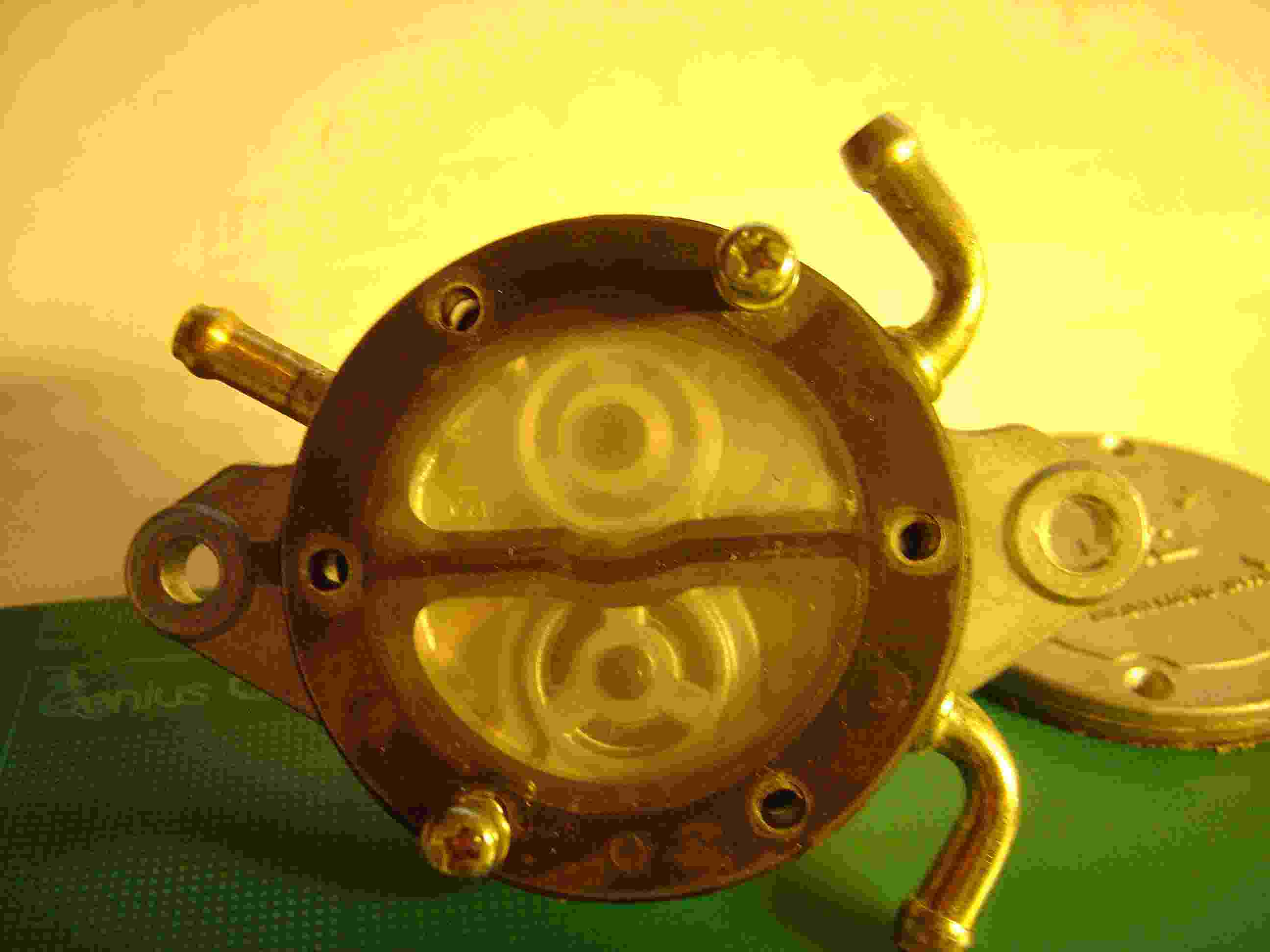

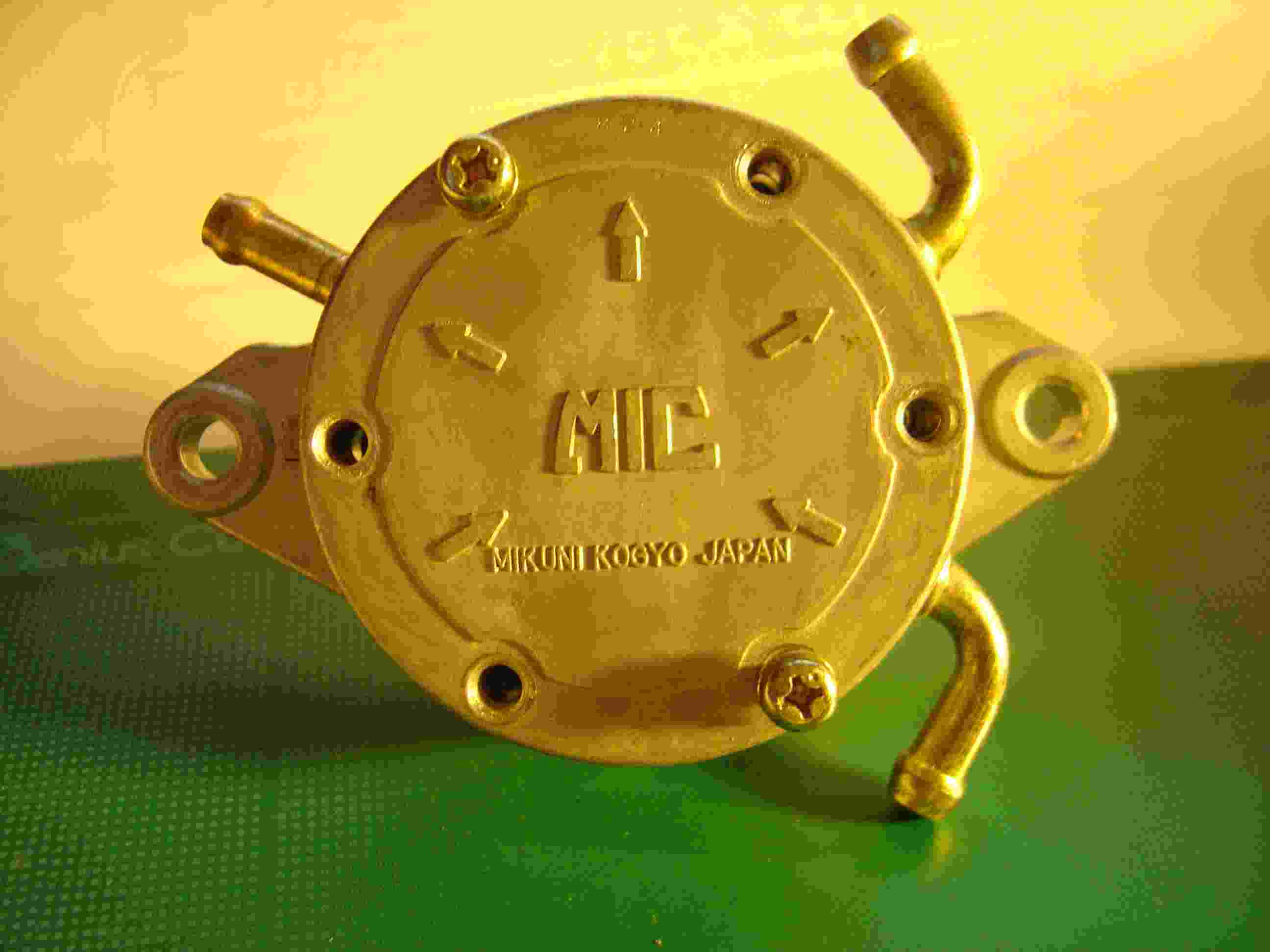

Well here's my first attachment. The first picture shows the round Mikuni
(DF 52). Here you'll see the inlet at the lower right side. Also the
in/out fittings is marked with arrows.
The next picture show the center part of the pump, the lower part is the
inlet camber with the one way valve directed into the picture, fuel going
from here and into the "wet" pulsing camber on the reverse side of center
unit. The upper camber is the outlet camber, here the fuel is being pumped
from the "wet" pulsing camber via the one way valve going toward us.
You'll see that both valves is located in the top position, allowing air
to escape easily. If this pump is installed horizontally, the air must go
downward to escape the camber- so if we can do that...
I've got a picture of both, the "wet" pulse camber and the dry pulse
chamber, but in order to keep attachment size at minimum, I skipped two
pictures, however can send them if needed.
Just a little note here; as you can see there is space to install a third
pressure outlet right on the top of the center unit, this will make the
pump even more efficient.
Torgeir.
