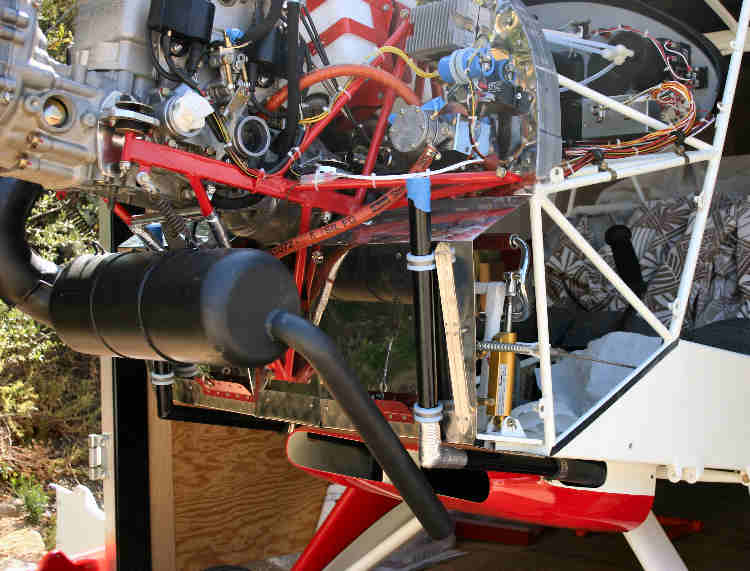

PostPosted: Mon Jun 12, 2006 6:13 pm    Post subject: More 582 Temperature Questions Reply with quote
The pipe was on when I bought the plane. It is an extension of the
regular pipe. It's the same type of pipe that is flared and bolted on.
It keeps the exhaust heat away from the rad and the landing gear (leg
and bungee) stays clean. See the attached photo.
Mike

bnn(at)nethere.com
PostPosted: Mon Jun 12, 2006 7:11 pm    Post subject: More 582 Temperature Questions Reply with quote
WOW! Now that's a pipe, baby! I wonder if it modifies the horsepower curve?
Guy Buchanan
K-IV 1200 / 582-C / Warp / 99.9% done, thanks mostly to Bob Ducar.

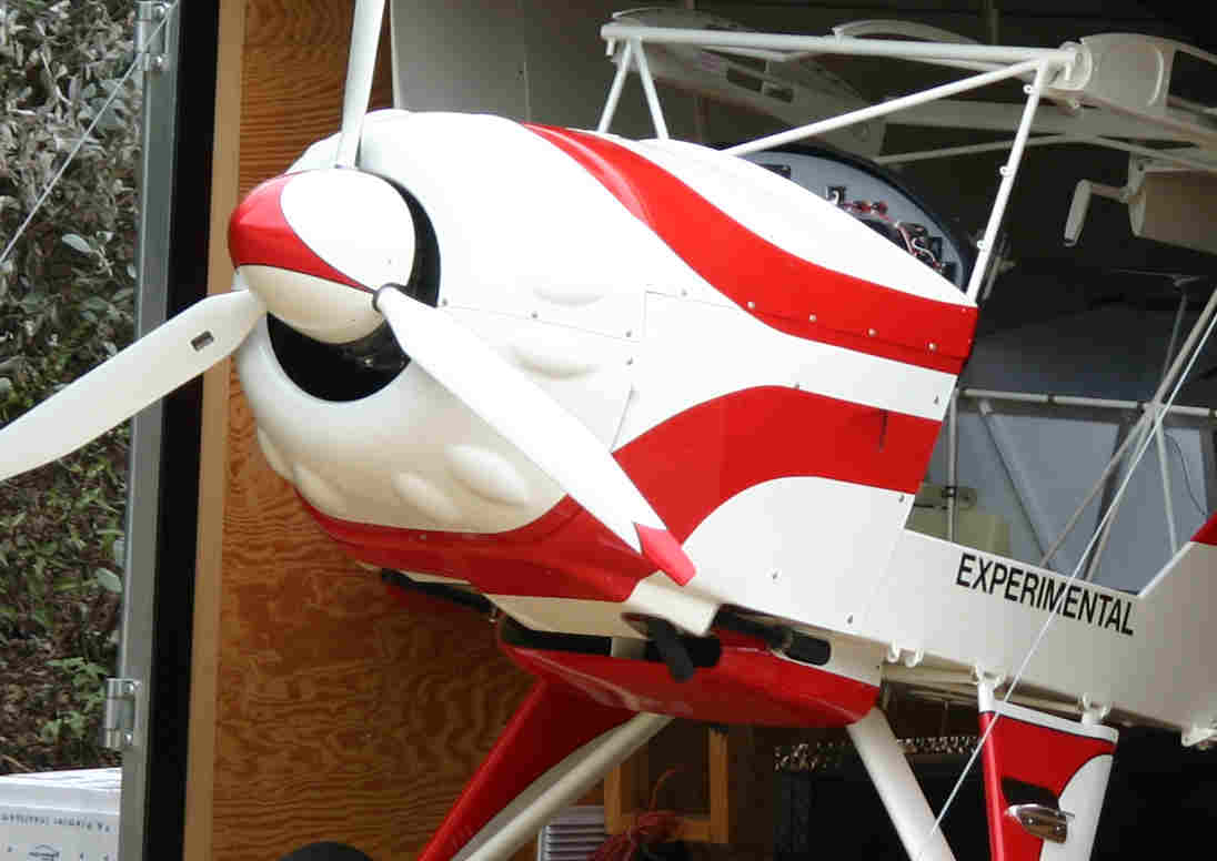

bnn(at)nethere.com
PostPosted: Tue Jun 13, 2006 8:19 pm    Post subject: More 582 Temperature Questions Reply with quote
At 05:49 AM 6/13/2006, you wrote:
Guy, could you take a picute of your setup ? Now that attachments can be
added to post it would make it more clear. Did you say you have a cowl
over the radiator or is it original?
I think it's the Speedster cowl. I've added a back plate which forces all
the incoming air through the radiator. I'll dig up a picture.

dave(at)cfisher.com
PostPosted: Tue Jun 13, 2006 9:36 pm    Post subject: More 582 Temperature Questions Reply with quote
Guy nice pics,
It might be me, but that air scoop looks like it is restricted by the cowl
exit.
That rad cowl i doubt will help you on cooling on the ground. In the air I
am not sure.
Bob Robertson is a good guy and I would expect he had no cooling issues but
most likely a larger cooling source than a OEM Skystar rad. My rad is
about 4 inch x 20 inch by 2 inch thick with 582.

Guy nice pics,
exit.
Well the ONLY exit is the radiator, so in a sense it IS restricted. I
thought that might be a good thing, increasing the static pressure in front
of the radiator. I suppose it's possible that the radiator cools around the
edges as much as across the core...
That sounds about like mine, though I doubt mine is two inches thick, more
like 1.5. It's the stock Skystar unit. I like Murle's aluminum radiator a
lot. I wonder if it's interchangeable with the Skystar unit?
Fuel flow can be checked static as well. You will need min. 6 to 7 gals
free flow per hour from gravity alone.
I had 12 gph static sitting on the wheels with 1 gallon in the tanks. I
plan to put the mains on 10" ramps and check it again.
You should get increased fuel flow from Pitot tubes on caps if they sealed
properly.
Yeah, I heard about the sealing problem. It's a good reminder to make sure
they seal well.
Sharp looking Kitfox and I hope the temperature does not run as red as the
paint job Smile
Thanks.
I see that it is 99.9 % done - does that mean a test flight any day now ?
My DAR will be in town the 17th. I'm hoping to have it inspected within the
week. I think I'll then trailer it up to Corona and have Dave Stevenson
check it out and fly it. Bottom line - less than two weeks.
Guy Buchanan
bnn(at)nethere.com
PostPosted: Wed Jun 14, 2006 7:03 am    Post subject: More 582 Temperature Questions Reply with quote
At 04:57 AM 6/14/2006, you wrote:
Guy,
Nice pics.
Thanks.
You can do a fuel flow check easily by taking loose the fuel
line at the input of the fuel pump and letting it gravity drain in a bucket.
You want 150% fuel flow based on the max fuel usage of the engine or say,
150% X 7 gallons = 10.5 gallons per hour.
I did that and got about 12 gph with 1 gallon in the tanks. I'm going to do
it again with the mains on ramps.
I noticed something in your picture that I think it wrong. Your fuel
pump is mounted on it's side and should be mounted flat with the pulse line
on the bottom. I've read this in several articles and not sure how
important it is. I've seen a batch of ultralights with the pump mounted on
it side.
Yes. I've heard about this. The micro drain for the pulse pump is in the
input elbow which enters the center of the back side of the pump. Thus,
with the pump sideways the pressure side of the pump will eventually fill
with fluid to half way, possibly reducing the efficiency of the pump. (I
haven't decided if it will, as theoretically the pump would work even full
of fluid, but with some reduction in efficiency caused by the increased
fluid friction of the liquid.) However, the hole for the drain is so small,
(so as to minimize the pulse loss,) that I have serious doubts it would
drain fuel if horizontal! (Small hole syndrome. Wink Of course, once the
pulsing started it would probably spit out any fuel in that cavity.)
Unfortunately my pump was mounted when I got the aircraft; It's what
Skystar recommended; no SB or SL's come out about it; and many others have
mounted them the same way. I think I will replace the input elbow with one
with no hole, then drill a similar sized hole in the bottom of the pulse
cavity - same effect, vertical mount.
Just curious as to why you need to do another hours worth of high speed
engine running???
I want to check the extreme climb, empty tank flow and the extreme descent,
empty tank time to exhaustion.
Guy Buchanan
