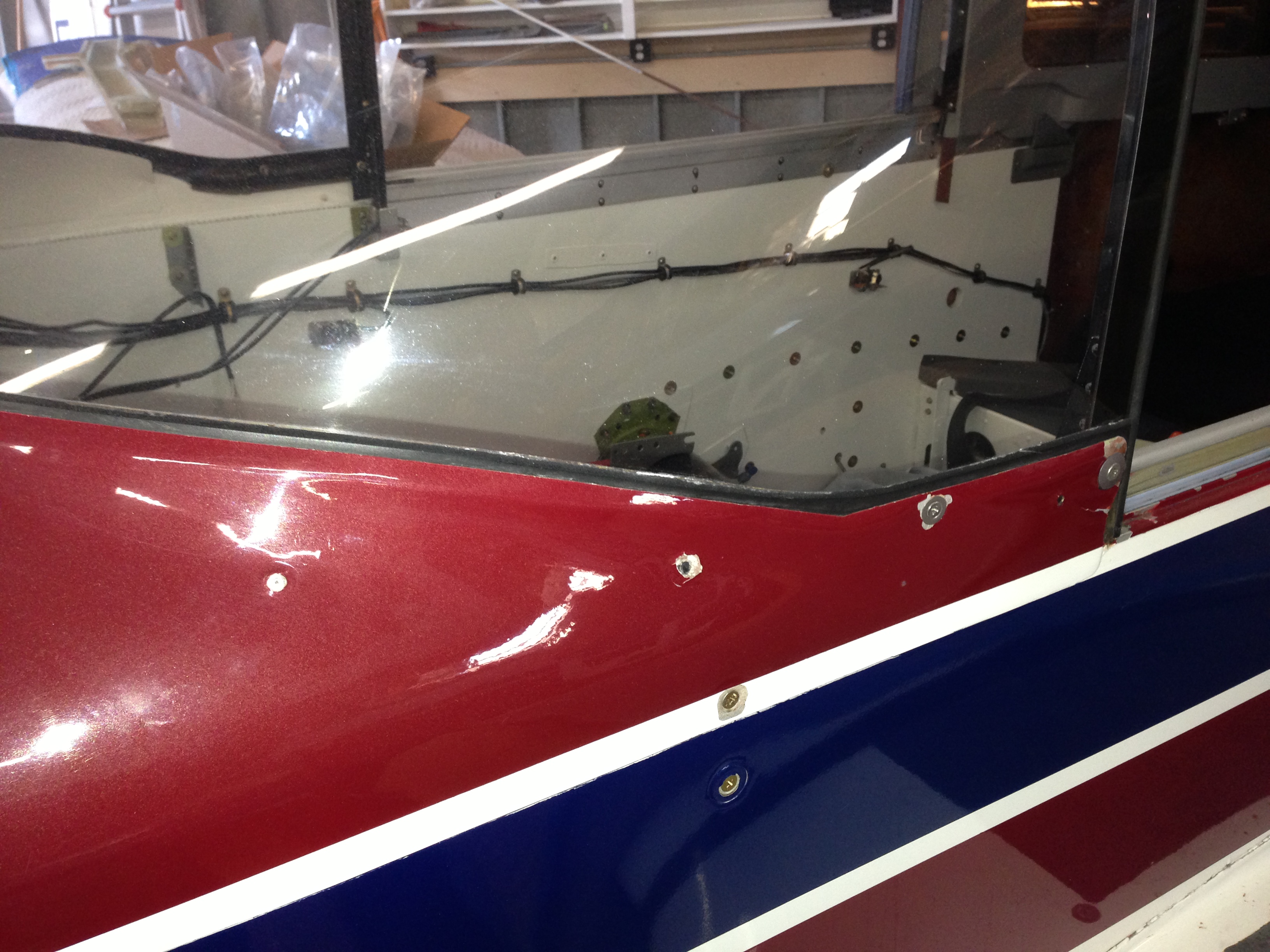

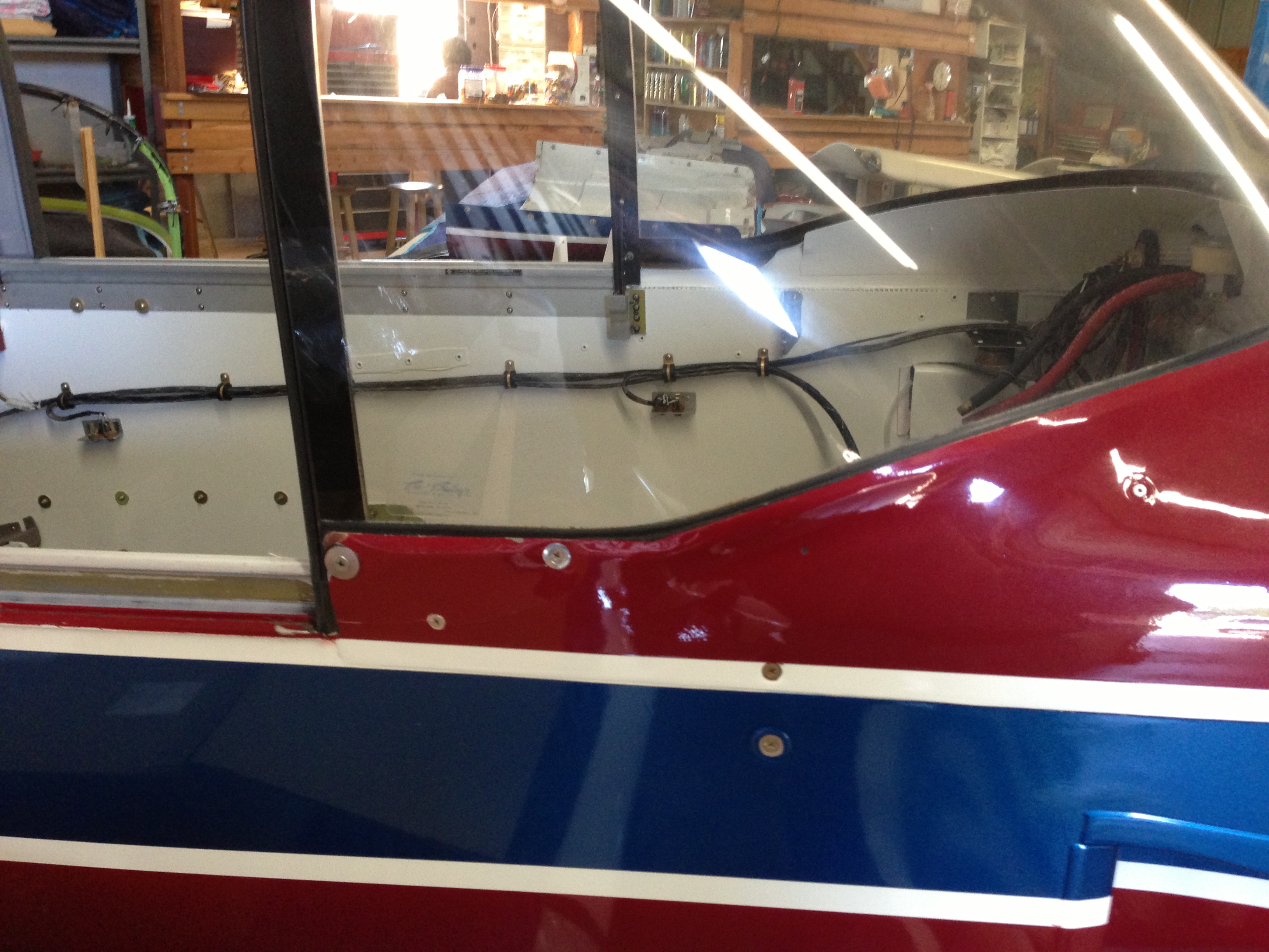

Someone asked about sealing the windshield. Personally, I think the whole strip caulk thing is a dumb idea.
Using a canopy bow seal around the base of the windshield is a lot of work too, but, it won't leak. The only problem I've seen is the left side working its way up the window after a year or so. Weird.

Once more with pics.

PostPosted: Thu Apr 25, 2013 4:53 am    Post subject: Windshield seal Reply with quote
Gary, are you using the black RTV that is used for the bow for the base of the w/s also? If so are you applying the bonding agent to the w/s like you do for the bow?

PostPosted: Thu Apr 25, 2013 10:20 am    Post subject: Windshield seal Reply with quote
I glue the canopy bow seal (it's the flat seal at the front of the canopy bow) to the bottom of the windshield with contact cement.

PostPosted: Thu Apr 25, 2013 10:47 am    Post subject: Windshield seal Reply with quote
Ok I understand now. Don't you worry about the sun eventually destroying it?

teamgrumman(at)yahoo.com
PostPosted: Thu Apr 25, 2013 11:00 am    Post subject: Windshield seal Reply with quote
Hadn't thought about the sun. I've had mine in there for 8 years.
