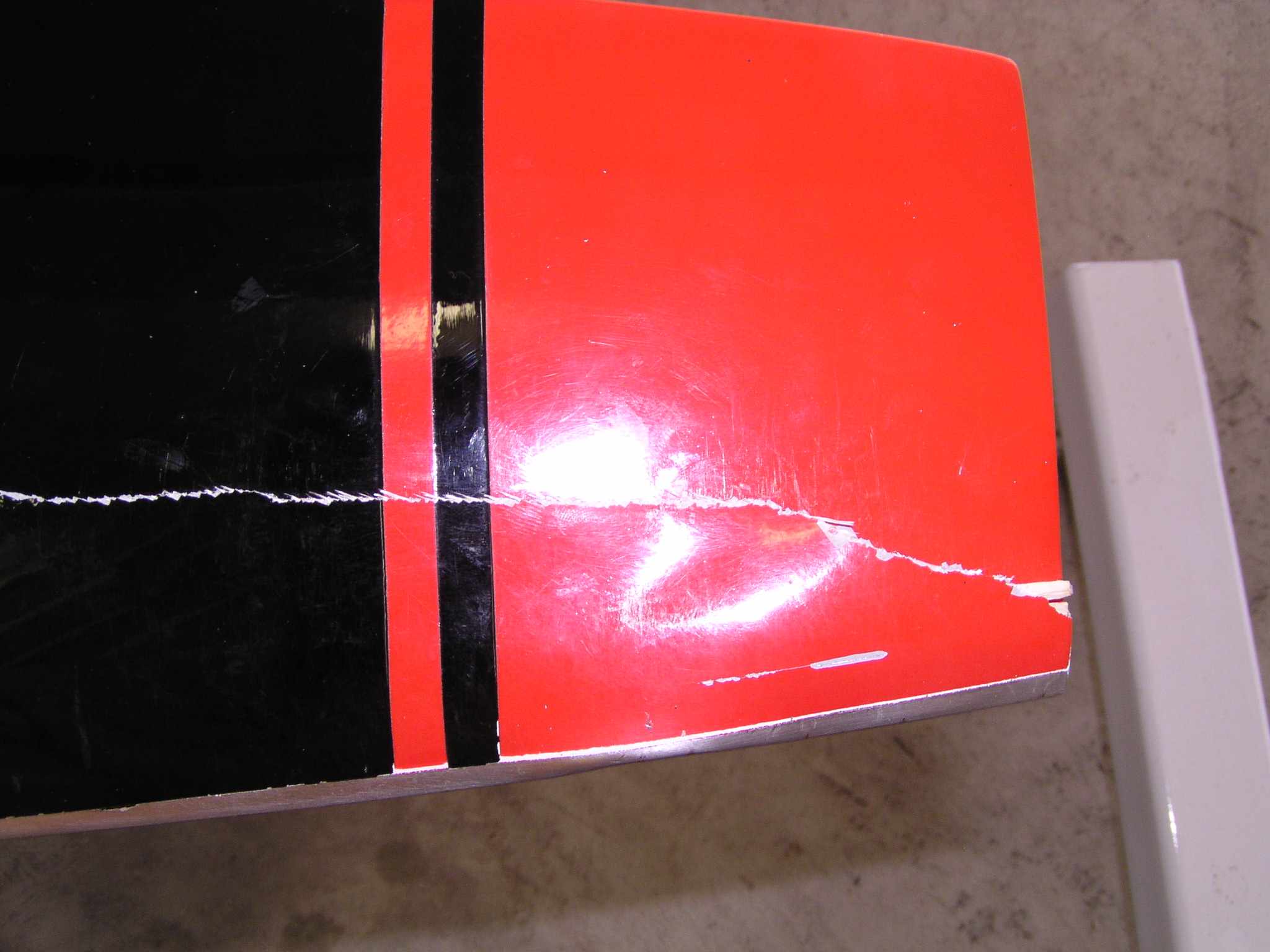

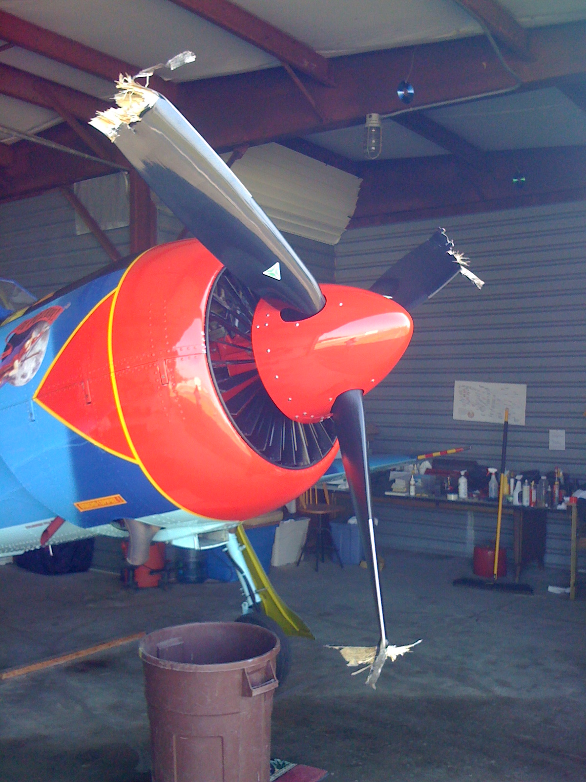

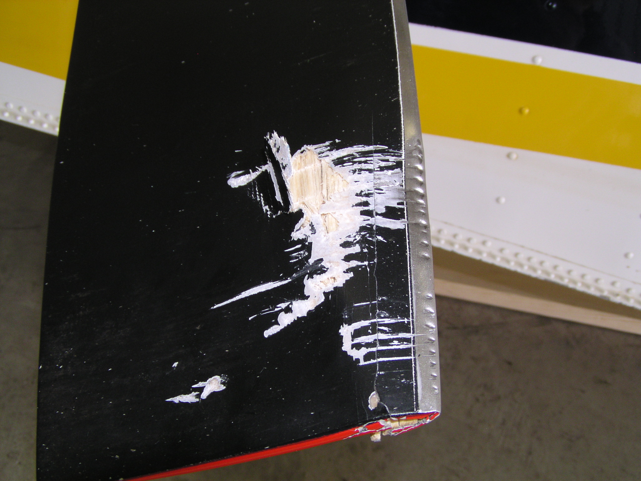

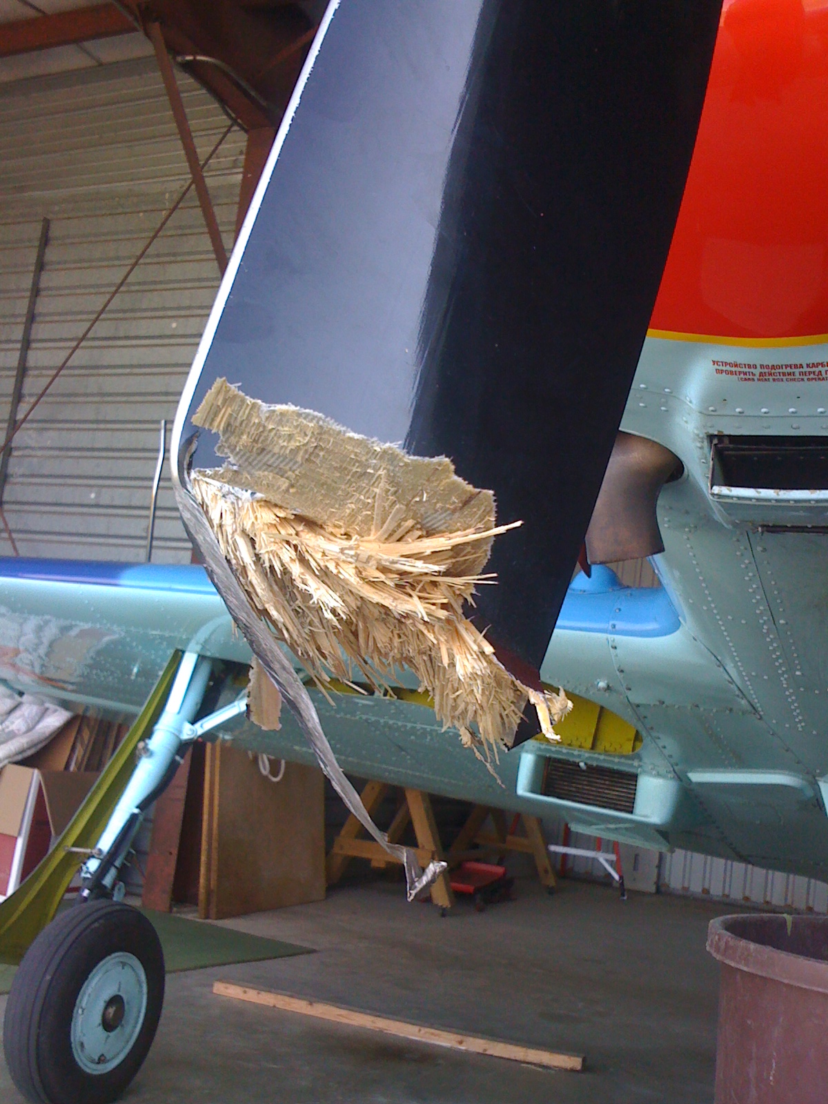

Most prop strikes occur with wood composite or carbon fiber blades. (We
haven't had a prop strike teardown with a metal prop, yet.) The inertia of
energy is absorbed by the blades disintegrating or being shaved off.
I agree with your assessment of a hydraulic lock on startup, but not when
the engine fires and it pulls fuel or oil in from the intake tubes. If it
fires, there is a good likelihood that the accessory shaft will twist.
At landing speed, the aircraft travels 3.5 feet for each blade in contact
with the ground at initial point of contact. As the engine slows, this
increases. Consequently, the rearward deflection of a very thin blade
exceeds the rotational shearing. Additionally, the reduction of blade
length per rotation with a normal flare landing is less than a tenth of an
inch. In other words, the wood fails well before any engine parts are
stressed to the +400 foot/lbs of torque design load.

A couple years ago I watched as one of our NE guys tried to make a left turn onto a taxiway in his -52TD just as his right brake froze up. The nose went over, with a high power setting, and the prop hit the pavement.
The last 12 inches or so of every blade was reduced to a million splinters in about one second! (Hence, his new callsign.) A broom and dustpan was used to sweep up what used to be three prop blades.
I don't believe the engine was damaged at all.

PostPosted: Mon Apr 29, 2013 6:10 am    Post subject: Hydraulic Lock Reply with quote
This is true - it was an amazing shower of sawdust! It did not tip up
very fast - it was a slow motion kind of thing which meant that I knew
exactly what was about to happen even with stick full aft and pulling
the power. We tore down the nose case and had the components tested
however they needed to be tested and nothing was out of order. We had
other tests done that were either prescribed in the manuals or deemed
appropriate for the situation. Results were all nominal. We put it
back together and that was probably 200 hours ago.

PostPosted: Mon Apr 29, 2013 10:22 am    Post subject: Hydraulic Lock Reply with quote
Reade, Holy shit what a picture !! I would have been sick I think.
I was worried about mine - happened in 2005, taxing at OSH prior to air venture - hit something with only one blade. They were establishing all the alternative ground taxi patterns. Other 2 blades ok.
Now 300 hours later no issues.

PostPosted: Mon Apr 29, 2013 10:58 am    Post subject: Hydraulic Lock Reply with quote
Yeah - it was not a great way to end the day. It was the last flight of
the day - I was doing a practice 4 ship flight as lead. As I was
taxiing I could not get it to turn left. I stopped and tried to taxing
again attempting a left turn and all it wanted to do was go straight
-but it did seem to exhibit some left braking. I stopped again and then
tried once more trying a little extra power to use the rudder to help.
As I began to move forward cycling the brake handle about the third
squeeze the brakes just locked up and the tail began to rise from power
and momentum. I pulled it back but too late. The one fortunate thing
is that the engine stopped with one of the blades on the ground - in
other words the blade held the cowl off the ground. After the Oscar
Sierra moment I shut everything down, a couple of buddies came over and
pulled the tail out of the sky and we got out and promptly pushed it out
of the way and into a hangar. As noted by Mozam, just a lot of
splinters on the ground. Not one mark out of the pavement.
Interestingly, the FAA was at this event. I had to provide my paperwork
(she looked at everything - program letter, registration, AC, parachute
repack date - all was in order!) and she wrote up a report. The next
day an inspector came out and determined that no property was damaged
and he simply called it an incident and not an accident. I had to let
them know when it was made airworthy again and that was it.
The MT prop is wonderful. But it is crazy expensive and the lead times
are awful. Insurance less deductible worked as expected. Needless to
say, the out of pocket still had some sting to it. The brake reduction
valve was replaced and all has been fine ever since. One expensive and
humbling way to get a call sign!
