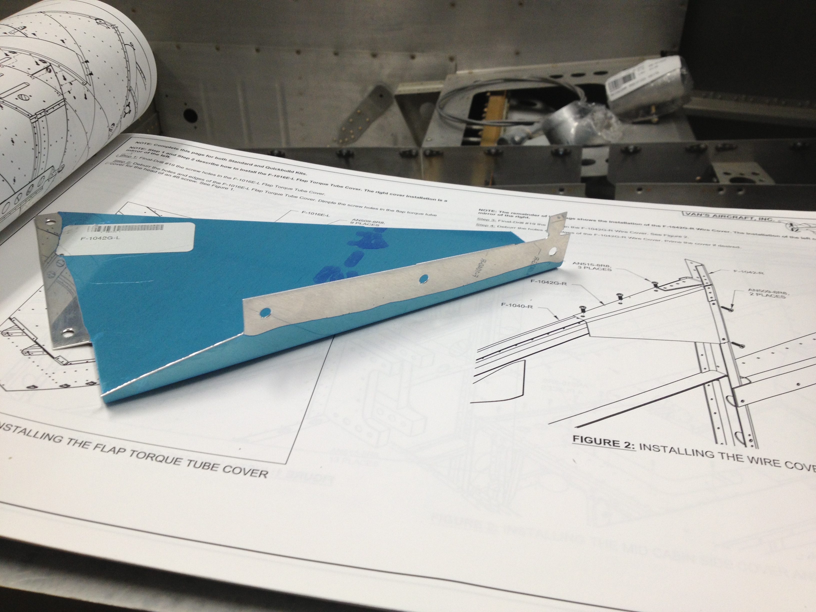

I know it is a small detail, but my manual has no indication about what to do to the small tab (you can see it in the attached picture) which comes in both the F-1042G- L & R wire covers to be installed in each side of the fuselage, near the instrument panel.
Are those tabs to be bended up, and then make a hole and rivet them to the fuselage skins?
Or are they to be bended down and just inserted between the skin and the longeron?
Carlos

I think that just gets cut off.  IIRC the screws are the only thing attaching the cover to the fuselage.
You might want to think carefully about the forward vertical screw.  It can be tricky to remove once the glareshield goes in.  If it protrudes very high, it can get in the way of panel going in or coming out.  An allen-type screw might be helpful there, or a flush screw.
