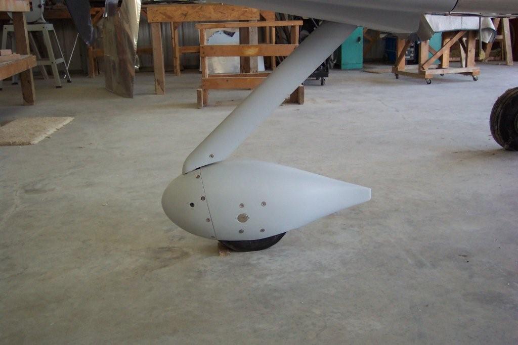

Photo attached of my Lowes-8A with metal inflation cap.
Robin

Lowes Aircraft Supply makes a perfect metal plug for the hole you described (I think I use one that's about 1.25"). It's in the odds and ends cabinets in their hardware section.
Marcus
