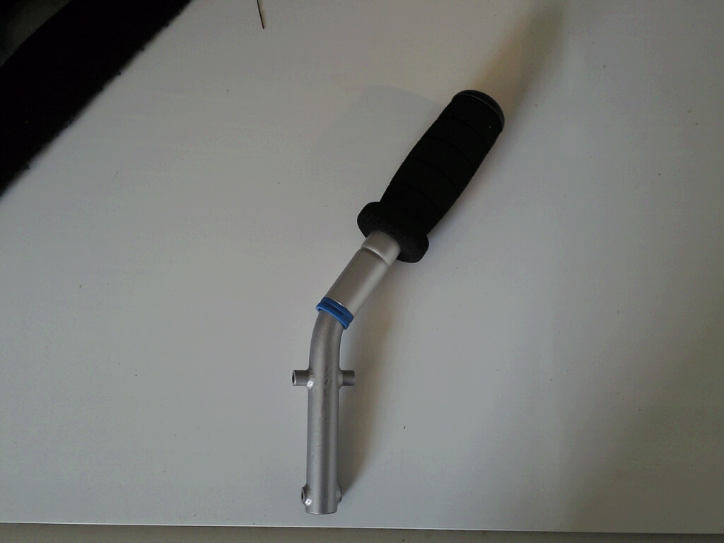

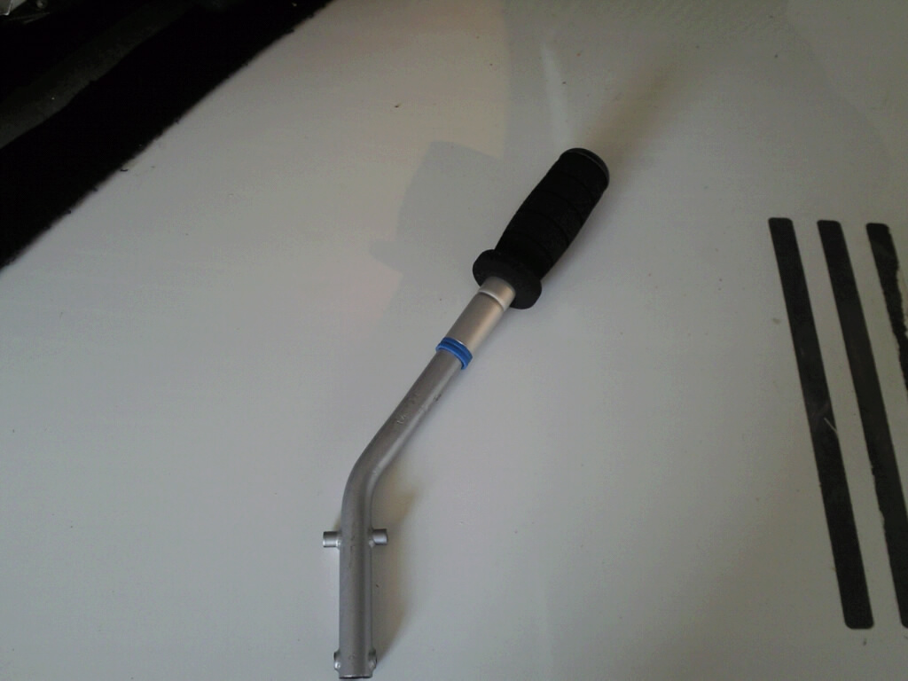

Hi Guys,
  I reworked my Stick to lighten the adjust Aileron feel .. and to be able to have my lapboard/Ipad etc on my lap .... also nice to have retracted for xcountry with the wing leveler engaged etc too
Bit novel but works fine fine .!
Graham

Grahm, can you post some photos of your setup?

G'day Galin,
  Actually I attached a couple pics with my post ..... Can resend later when I get hm if u haven't received ... just a simple 'twist lock' telescope setup ... Haven't figured how to balance elevator feel though ... Luv to hear if anyone has a fix for that ... ??
Graham

THANKS! I was viewing the e-mail on my iPad so I didn't see the attached pics. :O)
