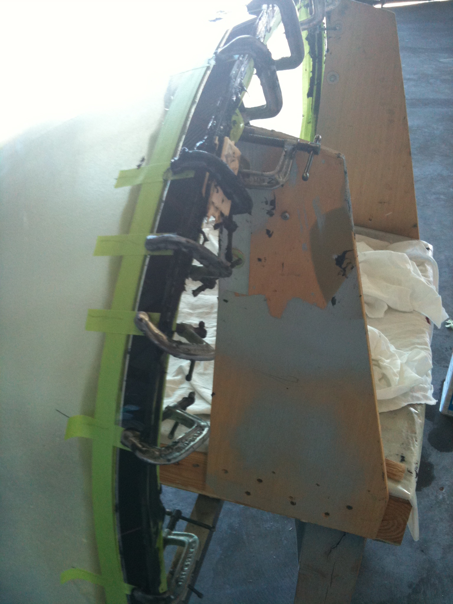

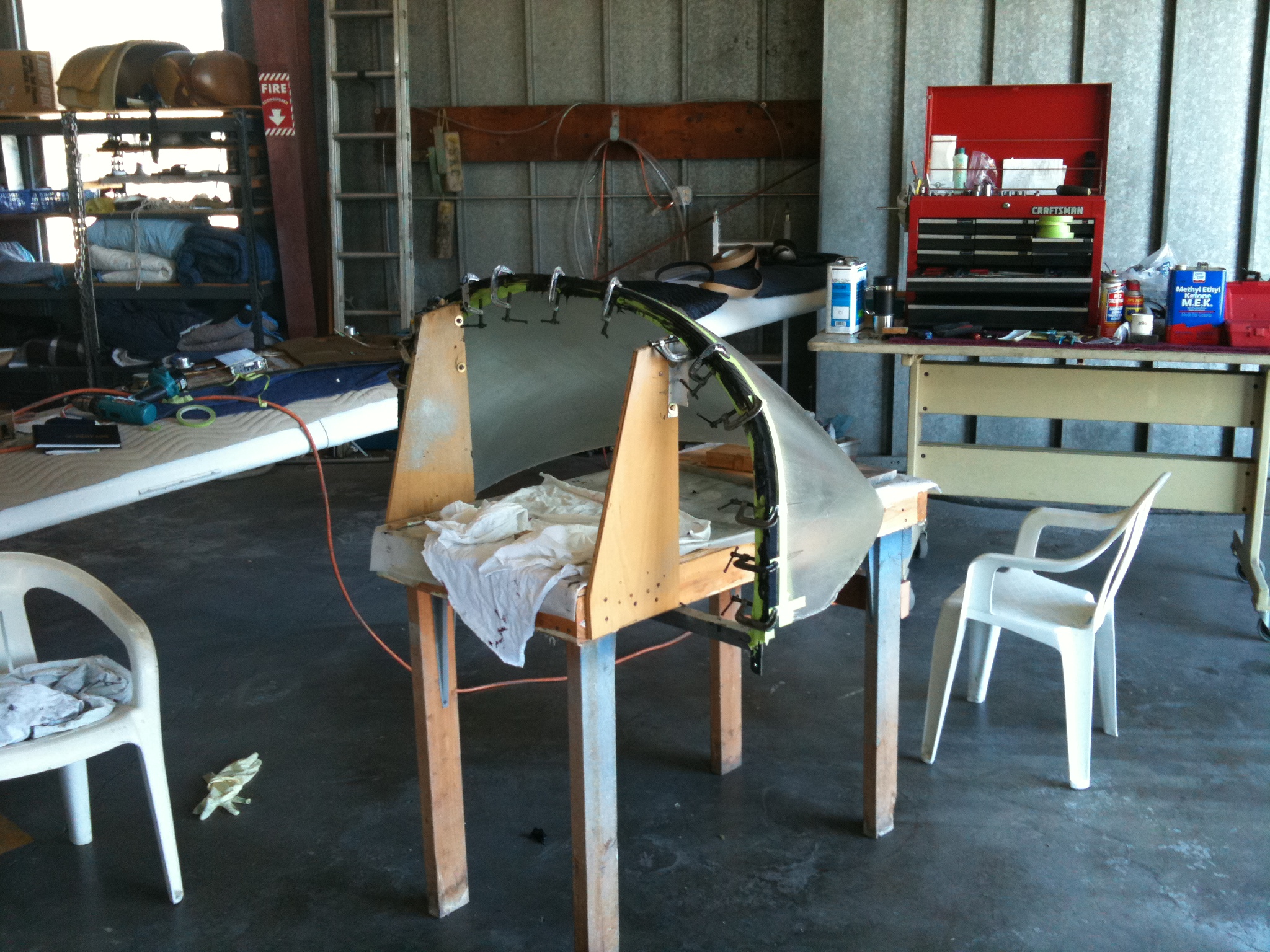

Background: I built a fixture to simulate the installation of the windshield. I use large area washers under the windshield to maintain a uniform .020 to .025 inches of clearance between the bow and the windshield. Each of the washers is located at the screw holes normally used to the double-bead seal in place. When installing the clamps, I only clamp until I barely see the washer through the windshield; that way, I know the gap at the front of the bow is about .020 inches.  This method works really well.
Note:  the pics show the fixture in 2006. It's undergone a major upgrade since then.
.... I had a customer come in that had a fairly new windshield, in pretty good shape, but it was completely debonded. I said I could re-bond it. I'd never re-bonded a windshield in the past. But, how hard could it be???? Right?
During the pre-fitting process, it was obvious I couldn't use the edge of the windshield to hold it away from the bow. Whoever had installed the windshield didn't trim to fit on the bow. The edge was anything but even with the bow. The holes on the lower corners had bee drilled twice. Once before installation, once, apparently, after the windshield was on the bow. The edge along the bottom is very close to the holes as well.
So, I was able to use some tiny spacers (between the windshield and bow) at the front where the windshield was even with the bow and at the bottom corners under the windshield. What to do about the corners? The corners measured between 0 and .010 inches with the windshield in place.
Solution: I drilled and tapped three #6 holes on the left and one #6 hole on the right. I installed small #6 screws in the holes and screwed them in until I got the .020 to .025 inches in the corners. While installing the windshield, I only had to press on the windshield with my hand to get contact with the screws. So far, it looks great.
When I remove the screws, I'll put some RTV in the holes.
Oh, yea, I prefer the old 732 RTV and 1220/1205 process.
