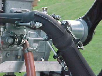

These are not stainless, and require a bit of welding and grinding, but they are about as bulletproof as it is possible to make: Go to Advance, Pep Boys, or your favorite purveyor of muffler clamps and get yourself 4 large clamps. Discard the U-bolts. Cut off the ends of the bent U-channel and weld them to the various parts of the exhaust system. Plan ahead, not all positions are equally useful.
Get some 5/16" common bolts at Lowes, drill them for cotter pins at the outer end of the threads. Get four stout springs to fit over the bolts and a handfull of washers, and put the whole mess together. Smear a little anti-seize in the ball joints.
Every 50 hours or so the bolts will get slightly worn away where they pass through the brackets; replace them. Since they are 5/16" bolts, they have to chew away a lot before you need to worry. You can get aircraft quality bolts if you want to, I think 5/16" common bolts are overkill, that's why I use them. Crude? Yeah. Heavy? Yeah. Likely to come apart and go through the prop? Not if you preflight and they are not grooved from wear.
And as my buddy Beauford would say: "Worth what ye paid fer it!"

PostPosted: Wed Apr 10, 2013 6:47 am    Post subject: Exhaust Clamps - 447 Reply with quote
Brother Pike:
Now that is super SLICK...! Yours put the commercially marketed clamps on
the night shift...!
You obviously have WAY too much time on your hands during the Tennessee
wintertime. I might be tempted to try
it if I weren't in the habit of cranking out welding that looks like the end
product of a grand-mal seizure.
Thankee fer the inspirational picture... now I'm depressed...
inadequate beauford.... sigh...
