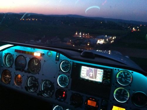

PostPosted: Tue Apr 02, 2013 2:41 pm    Post subject: LED strip lighting for panels Reply with quote
Robert L. Nuckolls, III a écrit :
If your airplane has a glare shield, you can
consider the used of LED strip lights similar
to these.
Hi Bob and all,
Just for the fun, this is what we did.
(Hope attachments are allowed).
Best regards,
Gilles
http://contrails.free.fr
 Filesize:  29.12 KB
 Viewed:  5657 Time(s)
