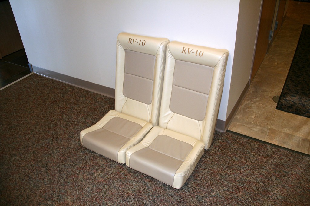

PostPosted: Mon Apr 01, 2013 11:58 am    Post subject: rear seat foam Reply with quote
Linn
I have the rear seat foams available like the ones Vans sells for $200.00 Here is a photo of recent seats I did. These have memory foam
in bottom cushions and high quality bolster foam
Geoff

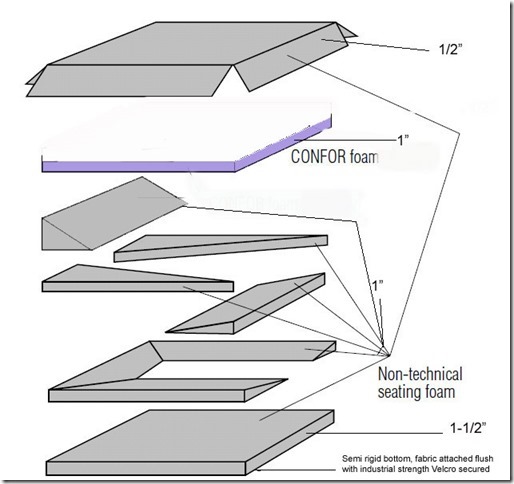

PostPosted: Mon Apr 01, 2013 2:08 pm    Post subject: rear seat foam Reply with quote
not really. Memory foam is over rated. None of my cars have it and they are quite comfortable when we drove for hours. When it gets cold, memory foam are like rock until warmed up. Forget the hype buy 2-3 sq ft of the memory foam for your bum and the rest can be the same foam used at car shops.
[img]cid:8D3D94C3E667474CA230BB539CEF6F75(at)pascalPC[/img]
I enclosed my seats layout for your review. This setup works today, I think this is the same setup as Vans- but I bet a good shop can duplicate it.

I went with the Van's rear seat foam. I get consistently good reports on back seat comfort from adults. I rode in Tim Olson's back seat in 2006 or 2007 and was impressed at how roomy the back seat is and how comfortable the seats are. I am 6'1" and usually (but not always!!) a bit north of 200 pounds.

PostPosted: Tue Apr 02, 2013 2:05 am    Post subject: rear seat foam Reply with quote
Pascal,
they came out very nice, you could marketing them and sell to get your
R&D back Wink
On 01.04.2013 22:16, Pascal wrote:
it’s all the same foam. You’re paying for the Name only. I know Oregon
Aero told me that needed to get their money back for their R&D on the
front seats and rear seats. I built my own rear seats and think I should
get $50 for my R&D.
