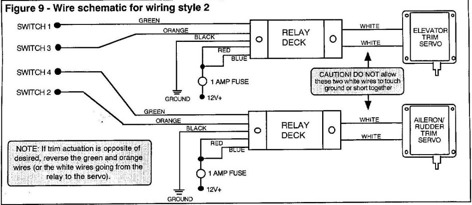

Can anyone shed some light on a question about the use of two Ray Allen
Company control stick grips with trim switches, two RAC relay decks, and
RAC servos for aileron and elevator trim? The RAC "Wire schematic" is
attached.
Do both sets of trim switches (the corresponding switches from grip 1
and grip 2) connect to the points labeled Switch 1, Switch3, Switch4,
and Switch2? To me the diagram doesn't make this clear.
Does anyone have a schematic diagram of a complete RAC trim system that
includes relay deck(s) and indicator(s)? The RAC documentation spreads
out the applicable information between the stick grip and the servo
manuals and it is more of a pictorial than a schematic diagram. I'd
particularly like to see what's inside the "relay deck".
Joe
Joe Dubner K7JD | 523 Cedar Avenue | users.lewiston.com/hth/jd/
Long-EZ 821RP | Lewiston, ID 83501 | +1 208 305-2688
 Filesize:  79.95 KB
 Viewed:  1128 Time(s)

jdubner(at)yahoo.com
PostPosted: Wed Jun 14, 2006 1:52 am    Post subject: Ray Allen Trim Servo Wiring Reply with quote
I didn't receive any meaningful responses to my original query but I
found a diagram on Bob's site (thanks, Bob!) that answers a lot of my
questions: http://www.aeroelectric.com/articles//trim.pdf
Let me phrase my original question another way: do both (pilot and
copilot) trim switches connect (in parallel) to the ORN and GRN wires of
the "MAC SERVO RELAY DECK" in the above diagram? I think so but I'd
like to hear from someone who has actually wired this system.
PostPosted: Mon Jun 26, 2006 10:18 am    Post subject: Ray Allen Trim Servo Wiring Reply with quote
Answering my own question here so that others may profit from my
research ...
I just got off the phone with Scott at RAC and he confirmed that two (or
any number) of trim switches can be connected to each input wire of a
relay deck. No isolation diodes are used with SPST switches to ground.
There is no inherent danger in activating multiple trim switches
simultaneously. And grounding both relay deck input wires
simultaneously will provide no output to the trim servo, just as if no
switch was activated.
Note that this information applies to an installation that uses two G305
Stick Grips, two REL-1 Servo Relay Decks, and two T2-7A servos. It does
not necessarily apply to *all* RAC trim installations. For example, the
RAC website shows a wiring diagram for RS2 Rocker Switches that requires
isolation diodes unless the RS2 switches are rewired in some unspecified
fashion. See http://www.rayallencompany.com/RACmedia/instructionstwoRS2.pdf
