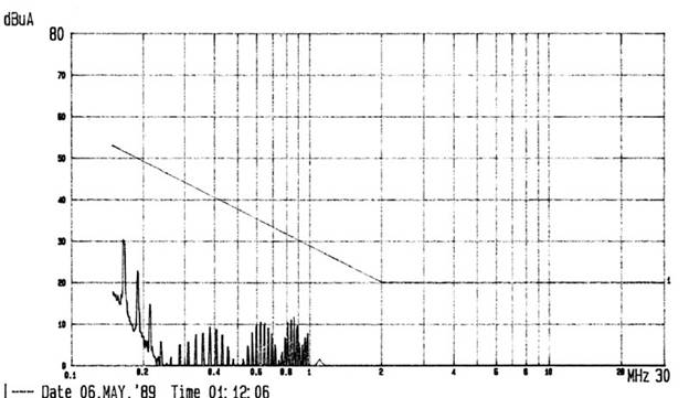

example, here's a plot of the noise from a blower
motor that was tearing up the ADF on a King Air
after I crafted a filter for it.
All I had to do was get the noise below the limit line
. . . in this case the filter was exceedingly effective.
But had my efforts produced a plot that was still
trashy out to 30MHz, all I have to do is get
below the limit line.
[img]cid:.0[/img]
Until we do similar investigations for our experiments,
the best we can expect is: "This experiment reduced noise
to the point where the customer doesn't care about what's
left over." It may still fail miserably in the DO-160
lab. Just because the original observer is satisfied with
the outcome does not mean all future observers will share
the perception.
