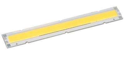

The item featured in the Jameco catalog has an
interesting form factor reminiscent of an EL light
panel. I'll get one and see what it's all about.

I've got one of these critters on order. They're back-ordered
for about 10 days. Must be a popular item. Here's the manufacturer's
data sheet
http://www.aeroelectric.com/Mfgr_Data/Lamps/JKL_Lamps/ZLP-MULTI.pdf
The item stocked by Jameco is 3.5" long by .48" wide and
draws 350 ma at it's rated 10.2 volts. It's also said to
have a max operating voltage of 12 volts. 3.5 watts
dissipated into this area and volume suggests it's a POWER
device with no particular power conditioning capabilities
built in. I.e. it would best be driven by a constant-current
power source (like the buck-pucks).
Will know more about it when we can get our hands on one.
