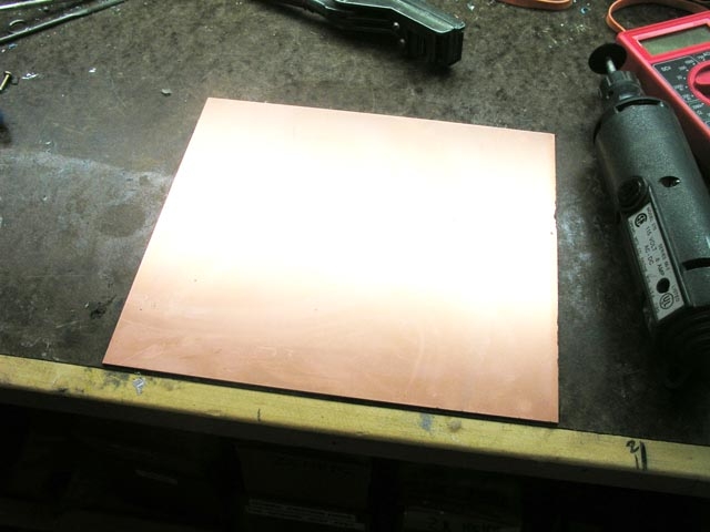

On several occasions I've thought it would be nice if a
vacuum vise I inherited from my dad would 'stay put'
better on the workbench. Seems it's difficult to pull a
lasting vacuum on a wooden surface.
A solution occurred to me a couple of days ago.
I used some E6000 to bond a 7 x 7 inch piece of copper
clad to the bench thusly.
[img]cid:.0[/img]
I weighted it down well and gave it 48 hours+
to get bonded. E6000 is a solvent based adhesive
and I wanted to give the solvents plenty of time
to escape from under the sheet.

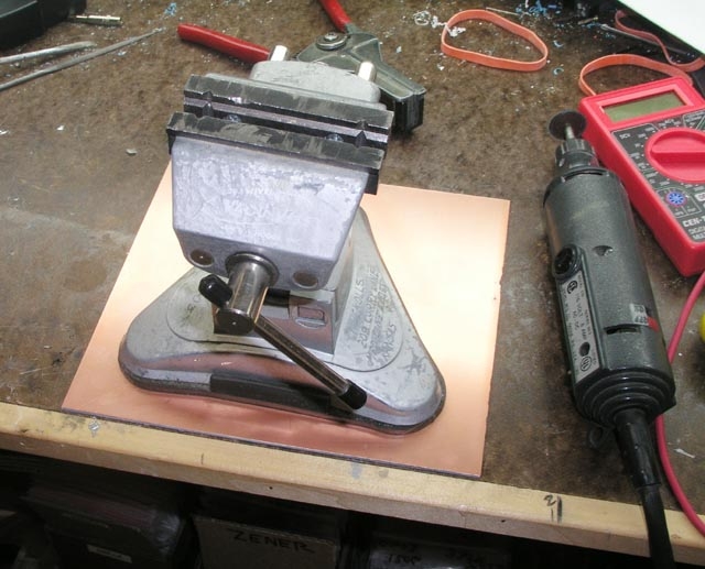

This produced a smooth, vacuum friendly surface . . .
[img]cid:.1[/img]
. . . yet thin enough not to be in the way when
the vise was not in service. You could do the same thing
with a piece of aluminum or perhaps some plastic that
was impervious to the effects of the E6000's solvents.
A thin steel sheet might be even better. Time tell how
well the copper clad stands up to the rigors of bench
surface before it too becomes 'leaky' . . .
By the way, the surface under the copper clad is tempered
Masonite. I use this to surface many of my benches attaching
it with flat head screws. When it gets too beaten to
clean up I can easily replace it for a whole new work
surface.

PostPosted: Wed Mar 20, 2013 9:10 am    Post subject: Vacuum vise Reply with quote
Bob,
Great idea! Very nice to be able to have a vise front and center when you need it and get it out of the way when you don't.
Re workbenches. I've made a couple of benches using a plain-front solid core interior door as the top. They're rigid, flat and stable, and come with a nicely finished surface. It's easy to fab and attach a simple support framework and legs with a few dollars worth of lumber and hardware.
Unfortunately, the nicely finished surface doesn't hold up very well to garage bench use. I'll try your idea and screw down a sheet of Masonite next time my bench needs a refinish. Thanks for the tip.
Eric
