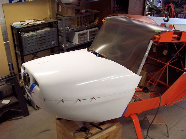

In addition to what Guy and Lowell have said, there is another way to
go...see if Pete at USJabiru still sells the Skyfox cowl made for the
Kitfox IV and the Jabiru engine. That is what I bought back in 2005
when I ordered my engine. There is still a bit of work to do to make
the cowl-to-windshield transition compatible, but for about $600
(2005 dollars) it's already shaped, and fits the engine like a glove.
The Top half overlaps the bottom with a "joggle" and the fit is
pretty good, but will take some cleaning up with a file or sandpaper.
The air inlets are properly sized for the 2200 engine, and there is
an opening for the oil cooler air. See picture of my cowl during
fitting.
