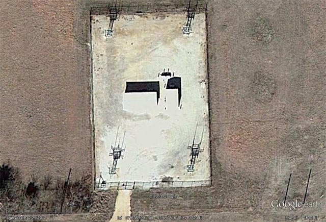

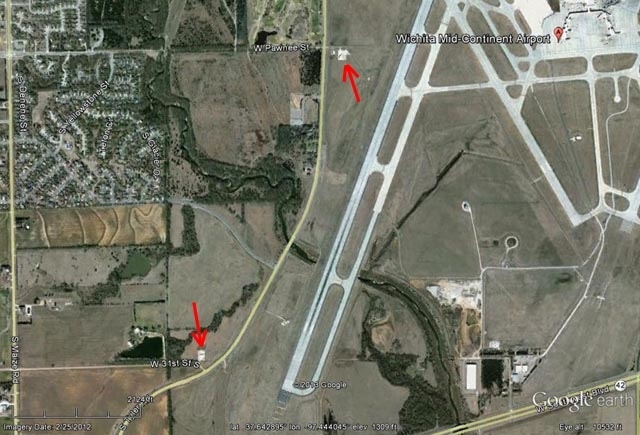

ATC facilities tend to co-locate their assets.
There's a couple of sites west and SW of the
ICT that feature an equipment building surrounded
by a quad of towers.
[img]cid:.0[/img]
Each tower mounts LOTS of antennas with each antenna
intended to service one radio in a shared RF environement
with lots of other radios. Unfortunately, this environment
is akin to an orchestra of a few dozen instruments on which
each user is playing their own tune.
[img]cid:.1[/img]
Back in my two-way radio days we used to call sites like this
"intermod city" referring to the difficulties of co-locating
many radios. The signals from two talking radios could 'mix'
in adjacent, overloaded receiver circuits to product poor behavior in the
offended radio and in rare cases, RERADIATE products of that
attack with sufficient strength to be heard by a sensitive receiver
some distance away.
When your observations mentioned involvement of ATC facilities
the first image that popped to mind was an un-mitigated intermod
situation on the ground . . . one that the controllers have been
made aware of and are able to react in some manner that makes it
go away even if they cannot fix it. Conversely, it may be a condition
that's on a list of squawks waiting for the techno-wienies to come
out and fix it.
Just a guess . . .
