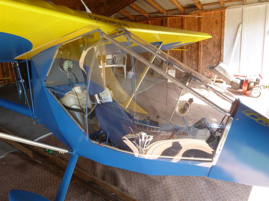

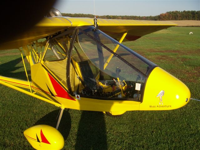

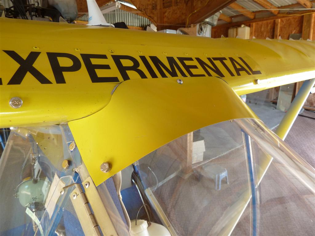

I've decided to enclose my Firestar II Cockpit because of the short flying season where I live. I've discussed this with Kolb Aircraft but as much as I would like to buy from Travis, I'm just not satisfied with the post running down the middle of canopy concept they offer in their after market kit.
I'm hoping to see some different ideas posted that Firestar owners have built ,and any pro's and con's of these original designs.
I've seen many cool ideas, but so far this design in the photo appeals to me the most .
Dennis
“I fly because it releases my mind from the tyranny of petty things…” – Antoine de Saint-Exupéry
 Filesize:  76.38 KB
 Viewed:  26136 Time(s)
herbgh(at)nctc.com
PostPosted: Sun Mar 03, 2013 11:15 am    Post subject: Kolb Firestar II Cockpit Enclosure Reply with quote
Kinda looks like the firefly , full enclosure...The lexan is the center
hinge...Fastens to the nose cone well down from center on the left
side...and same on the curved support at the rear...Just wraps over the
right side of the nose cone and rear frame...The left side and the right
are fitted with a piece of angle aluminum to firm up the lexan..the
angle on the right side provides attach points for the latch...The angle
on the left attaches to the cage longeron...Herb

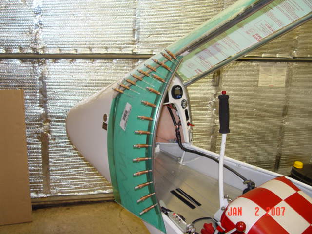

Dennis Thate
Joined: 18 Nov 2010
Posts: 362
PostPosted: Sun Mar 03, 2013 2:13 pm    Post subject: Re: Kolb Firestar II Cockpit Enclosure Reply with quote

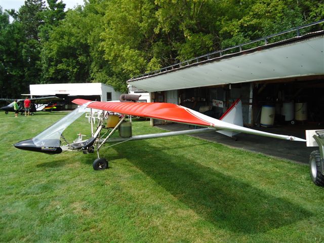

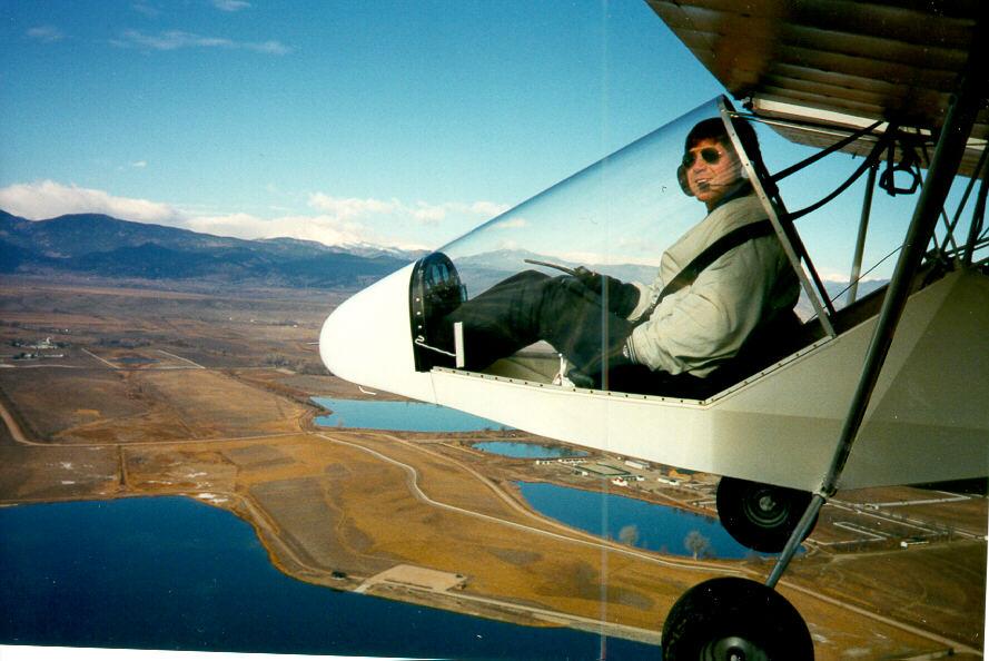

Just got this in a private e-mail... This is a fine piece of workmanship and I think this is exactly what I'm seeking!
Thanks for sharing !
 Filesize:  60.21 KB
 Viewed:  26119 Time(s)
herbgh(at)nctc.com

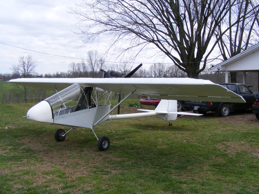

PostPosted: Sun Mar 03, 2013 2:30 pm    Post subject: Kolb Firestar II Cockpit Enclosure Reply with quote
Good design...but---way overbuilt ....check out the Firefly
enclosure...no tubing in the field of view...Almost no tubing at
all...Just a circular piece up near the wing to support the ,0625
lexan.. The curved lexan has quite a bit of strength...and is fine at
the speeds that we fly.. Herb

PostPosted: Sun Mar 03, 2013 3:34 pm    Post subject: Re: Kolb Firestar II Cockpit Enclosure Reply with quote
That's a beautiful firefly.
The overbuilt concept may be true, but still a great idea in event of a bird strike, something in my part of the country to be concerned about. A weight & balance to follow for sure.

Certainly a bird strike is a concern...I tend to think that the
curvature and toughness of the Lexan would negate a bird strike...
I had a close call some years back...Some kind of high flying "swift"
.I saw it as a speck and within seconds it went by me...We were closing
at a very high rate... Herb

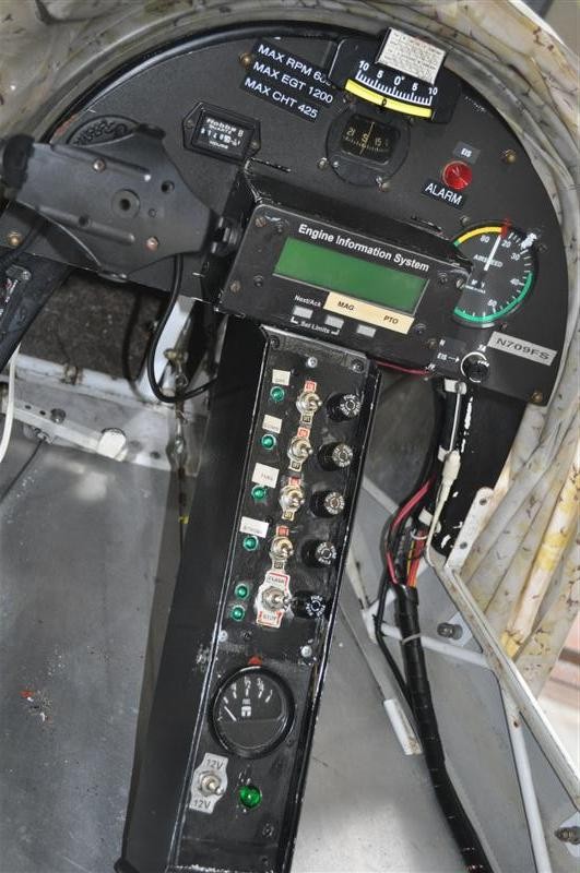

Hi All,
Dennis--Soon as the weather warms up a little I plan to cover the cage on my
firestar 11. I have enough .016 alum left over from the 701 project to skin it .
Don't know how much more it weighs but it shouldn't be much heavier than the
polyfiber.Plan to weld some tabs on the tubes and go from there.My main worry is if i can get it to look neat enough to suit me.The other thing is -- I plan to move my instrument
panel aft about 8''. As it is in the standard nose bowl from kolb , i can't reach my
EIS without using a stick to punch the buttons, also have trouble reading or changing
the GPS.

PostPosted: Mon Mar 04, 2013 7:48 am    Post subject: Kolb Firestar II Cockpit Enclosure Reply with quote
dennis
my eis had a plug on the back that had wires that would allow for remote
switches for the eis... and with the eis on my panel I located the remote
switches overhead, does your eis not have the remote switch capability?
boyd young

PostPosted: Mon Mar 04, 2013 7:59 am    Post subject: Kolb Firestar II Cockpit Enclosure Reply with quote
I put mine on the stick, and my GPS on my leg.Larry

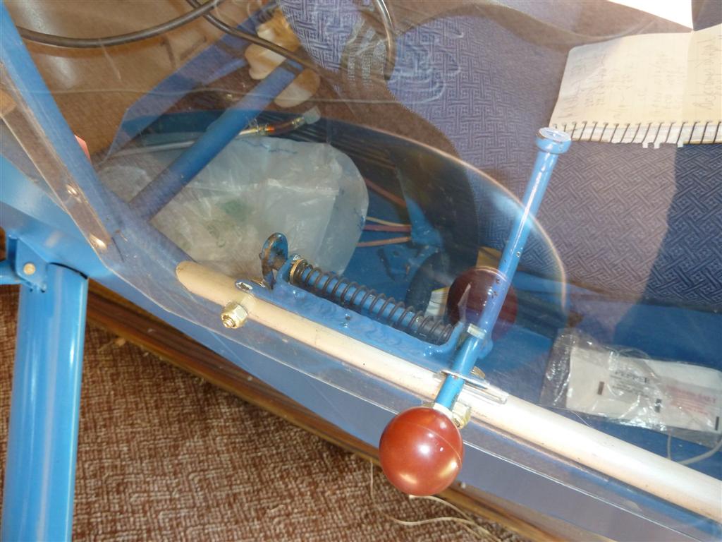

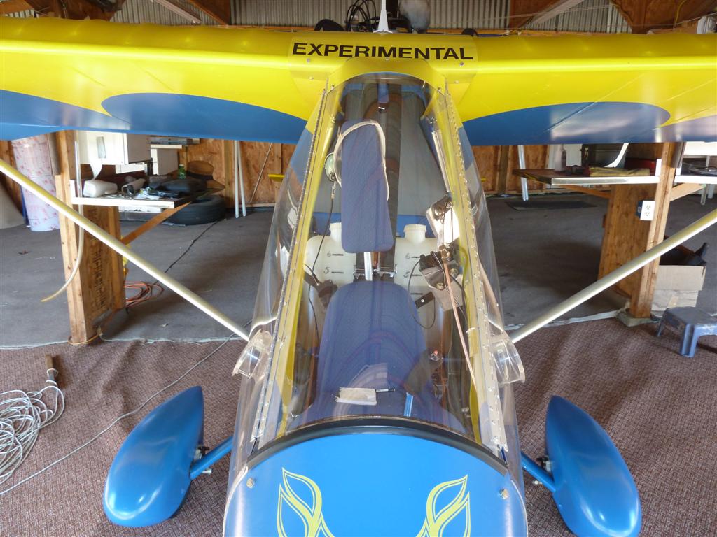

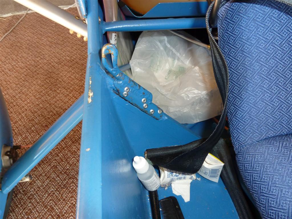

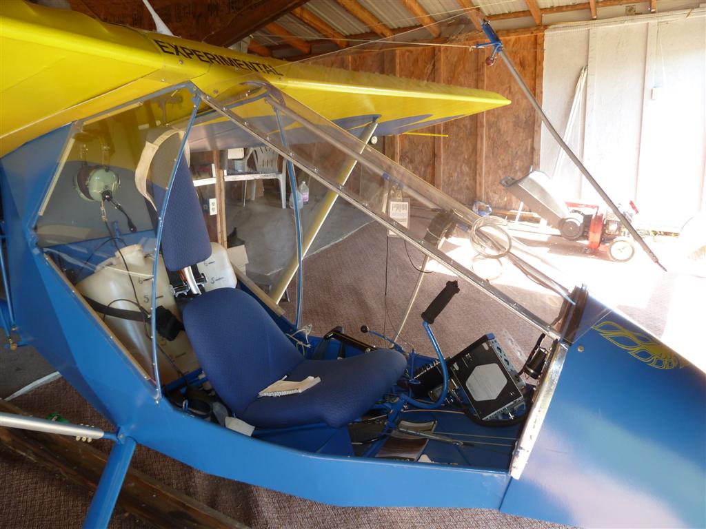

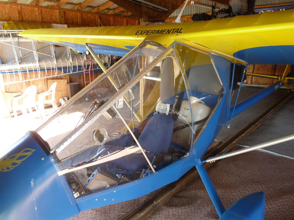

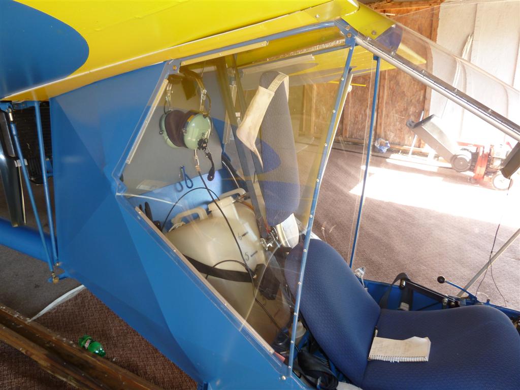

When we rebuilt N582EF after the crash, we did it this way. It works ok, and it is very airtight in winter. In summer, you about have to take out the back windows or it is too tight and you get too hot and stuffy.
We also had to put a padded partition between the cockpit and the storage area in back to try and reduce some of the noise.
If you have back problems or are not very flexible, you will have problems getting in and out, and you need to be able to fold and tuck your head to get in and out.
If I had it to do over, I would have made it about the same in the back, but done a one piece wrap instead to make it easier to get in and out.
Hope this gives you some more to think about.

PostPosted: Mon Mar 04, 2013 8:15 am    Post subject: Kolb Firestar II Cockpit Enclosure Reply with quote
Richard Pike
The windshield faring came out good.
If it wasn't so much work, I'd redo mine.

PostPosted: Tue Mar 05, 2013 5:08 am    Post subject: Re: Kolb Firestar II Cockpit Enclosure Reply with quote

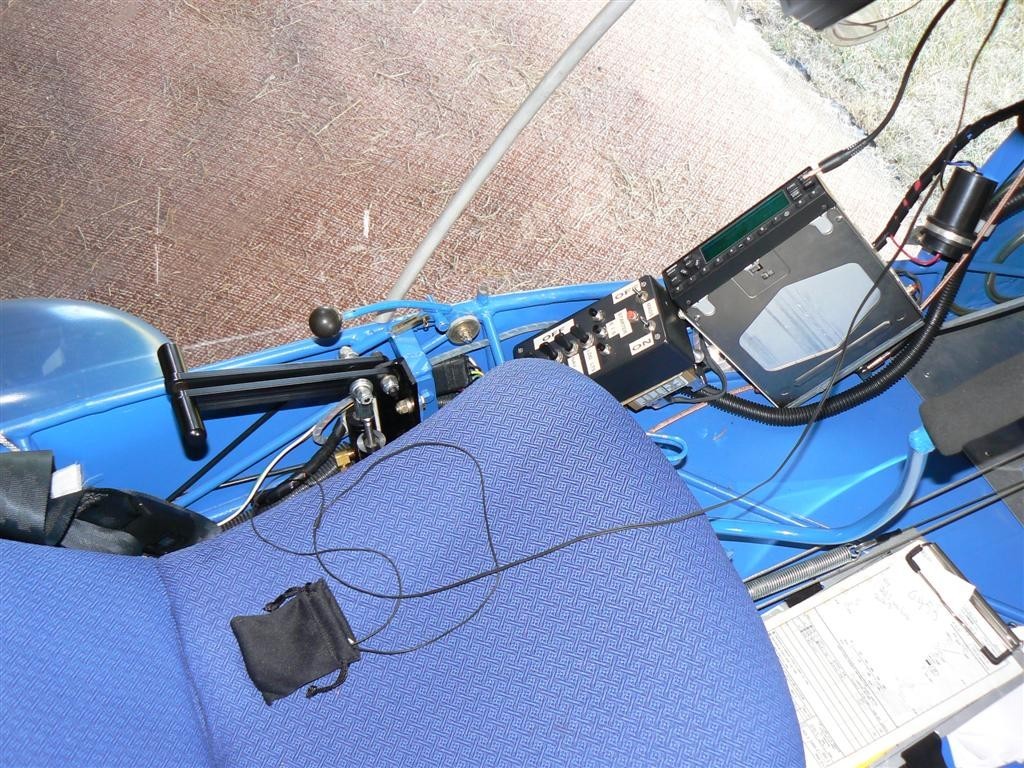

An alternative to extending the panel is to put your switches on the seat frame or other easy to reach location. My Slingshot has the EIS controls in the joystick grip, the two mag switches on the left side of seat frame, and the starter switch and electric elevator trim switch on the right side of the seat frame.

Dennis Thate
Joined: 18 Nov 2010
Posts: 362
PostPosted: Wed Mar 06, 2013 6:14 am    Post subject: Re: Kolb Firestar II Cockpit Enclosure Reply with quote
Thom,
Not sure who sent these to me last year, but both interesting ideas.
