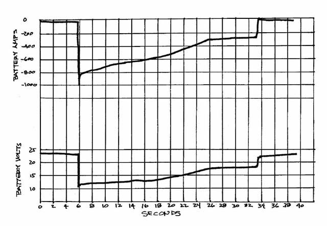

Have you conducted an energy study on your
anticipated operational needs? Certainly
a panel full of electro-whizzies drives notions
of extra-ordinary electrical system demands
but have you worked out the numbers?
What is passed around as common sense often
misses the mark for calculated reality. For
example, at a lunch time learning session at
HBC I put this plot up on the screen . . .
[img]cid:.0[/img]
This is an exemplar voltage-current plot for getting
the first engine started on a Beechjet. As you can see,
current flows are substantial and the duration is
considerably longer that what it takes to get your
4-banger lit. The battery that produced this
performance curve was rated at 35 a.h.
My question to those in attendance was, "What percentage
of battery capacity is expended in this event?" Guesses
were all over the place but I don't think anyone guessed
less than 25%. In fact, this event consumed about 6%
of total battery capacity.
I offer this anecdote to support the notion that the
perceived magnitude of a condition is often far removed
from reality.
My question about an energy study goes to your decision
to install 2 batteries and 2 alternators of significant
capacity in an RV. . . even if it does have a lot of
electro-whizzies.
The load well crafted load analysis will drive good
decisions on sizing batteries, alternators and crafting
a pre-flight check list that puts real numbers to
battery only ops before the engine is started. It
also encourages you to craft a plan-B condition where
en route endurance loads do not exceed 8A thus saving
a fully charged battery for approach to landing where
you can turn on anything you like.
I have yet to see a study for a configuration in an
RV that truly taxes a system to the extent that Z-14
yields a good return on investment. That's a
substantial increment in initial costs, weight,
and cost of operation as opposed to a Z-13/8 system
that offers nearly equal system reliability with
a much lower cost of ownership. You might find
it more attractive to trade empty weight for
fuel and/or baggage.
I suggest you run the exercise to prove to yourself
that Z-13/8 is indeed inadequate to your design
goals based on the numbers as opposed to square
inches of glass on the panel.
There are a number of exemplar exercises posted
at http://tinyurl.com/9rt6ymn along with a blank
form that can be used to put your arms around
the answer.
 Filesize:  109.38 KB
 Viewed:  4585 Time(s)
mrspudandcompany(at)veriz
