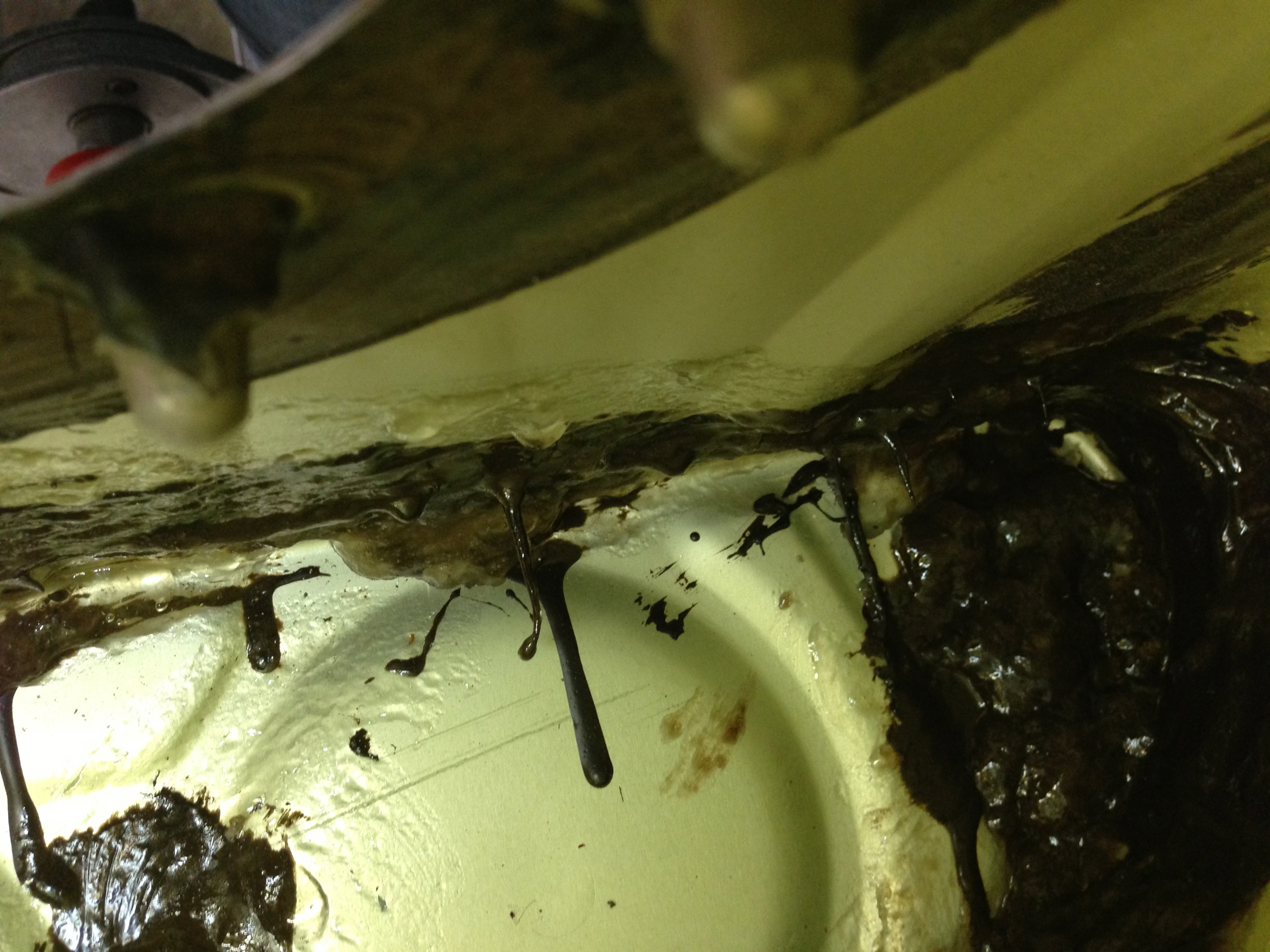

Fuel tank stalagmites

PostPosted: Wed Mar 13, 2013 7:37 pm    Post subject: Fuel tank stalagmites Reply with quote
Those are stalactites. Stalagmites grow from the floor up. I was taught it was easiest to remember that stalactites have to hold on tight to the ceiling. Had both in my fuel tank. Apparently I had a mechanic that thought more is better too, and one that couldn't tell the wing was delaminating. Got it all fixed now.

PostPosted: Wed Mar 13, 2013 7:40 pm    Post subject: Fuel tank stalagmites Reply with quote
Oh, you are right. Those are stalagmites. You took an upside down picture. Sorry about that.

teamgrumman(at)yahoo.com
PostPosted: Wed Mar 13, 2013 10:39 pm    Post subject: Fuel tank stalagmites Reply with quote
These are growing from the floor up. The wing must have been bottoms up when sealant was slopped in place. Then they let it drip down (up)
