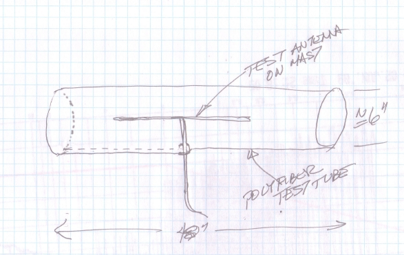

I have polyfiber leftovers to cover a box like that, and could use the opportunity as a covering demo/training for someone else.
   Great. I'm mulling over the geometry of a
   polyfiber 'test cell' that would facilitate
   relative attenuation measurements on a range
   of antennas. Structure for the cell should
   be RF transparent.
   I'm thinking of a cylindrical tube on the
   order of 6" diameter and 48" long covered
   with exemplar polyfiber finished fabric.
[img]cid:.0[/img]
   The tube would have a single split-cut over
   half the length to a mast clearance hole in
   the middle. This would allow it to be
   slipped over dipole antennas covering our
   range of interest. I'm thinking of tests at
   130, 330, and 1000 Mhz which can be generated
   and measured with equipment I have.
   I wonder if a cardboard tube of the smallest practice
   thickness could be used as a former. I considered
   plastic DWV pipe . . . but these materials have some
   degree of RF opacity. I guess we could have two
   such tubes, one that's covered and one that is
   not covered. That would wash out effects of the
   plastic in the sandwich layers. Your thoughts
   and the thoughts of others are welcome.
   I'm negotiating a business arrangement
   with a OBAM aircraft magazine to do a regular
   flow of articles. This experiment might provide
   the 'meat' for a first article .

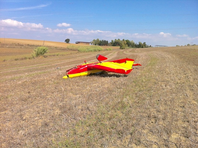

We had last year a forced landing here in Europe, because the rudder got detached after the start, flaring was difficult due to interference, that is how the
plane came to rest.
The antenna was broken off, but the ELT still worked, 15 minutes later the rescue helicopter arrived and the national organisation also called shortly after this as they did receive the alarm.
I would say a plus for the 406 System!
Werner

Would have to examine the wreckage to be sure but it appears this relatively mild crash could be a case of the antenna being only partially broken off. The remaining stub would be an excellent 406MHz radiator. If the antenna was totally removed from the feed cable then it is hard to see the physics which would allow satellite reception. Perhaps if part of the cable shield was torn off, exposing the inner conductor, then you would have a useable antenna. The point is we can have absolutely miserable antenna placement and still have adequate ELT performance. Hence the statement we are better to have the ELT antenna inside, intact and working poorly and outside, missing and not working at all.
This aircraft appears to be wood construction. If so, the inside of the tail cone would be an excellent location.
Tom Kuffel
