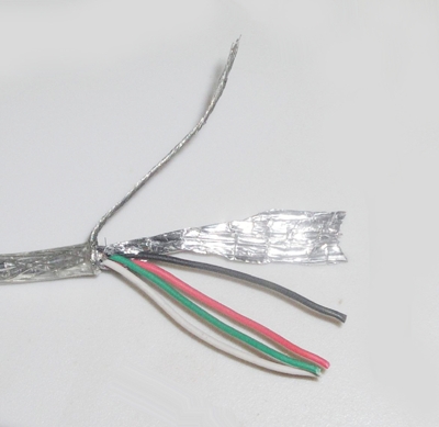

I've been pondering your question and have the following
suggestion. In my grab bag of cable assemblies I'm
seeing a family of USB cables that seem to offer a solution to
your problem. They're small in diameter, flexible,
plenty of conductors and shielded. Further, USB cables are
like rabbits put a few into a box for 'future use' and
in a year or so, they've multiplied in number exponentially.
[img]cid:.0[/img]
Try this wire on one of your target headsets as an
experiment. They're 4-conductor + shield. Very flexible,
reasonably robust. You can parallel extra conductors
or simply ignore them.

You could also use shielded network cables -- the kind with 4 pairs + overall screen.  They're easy to pick up on Amazon for next to nothing, or if you know a friendly IT department they're likely to have loads of them kicking around.
Possibly not the most flexible cable, but then again the leads on my Peltors aren't that flexible either.

Oh, and an alternative, if you only need three cores, would be headphone extension cables.  You can get them in screened flavour, again for a small price.
the kind with 4 pairs + overall screen. Â
again the leads on my Peltors aren't that flexible either.Â
These tend to be less flexible and most
use solid conductors. Good wire for situations
that do not have to be coiled/uncoiled and
moved around.
cores, would be headphone extension cables. Â
You can get them in screened flavour, again for a small price. Â
James
True. I think his headset cables would call for
5 conductors. Two floating for phones. One for
PTT, one for MIC HI and the shield conductor for
MIC LO/PTT LO.
Your point is well taken.

Sorry, this is me not being clear -- the cables I'm thinking of are the patch leads that you use in comms cabinets etc.  The ones I have are made of stranded cable.  Each wire has 7 strands.  Would that be flexible enough?

PostPosted: Wed Mar 06, 2013 5:22 pm    Post subject: Headset/Microphone cable replacement Reply with quote
in comms cabinets etc. Â The ones I have are
made of stranded cable. Â Each wire has 7
