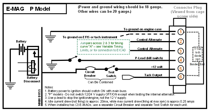

Referring to the Emagair literature we see:
[img]cid:.0[/img]
Current draw for this system at max RPM is only 0.25 amps! There are no
inrush currents associated powering up this system. From a systems perspective,
they would like to have +12 available all the time. There's no reason to 'switch
the supply on and off except to test the internal power source . . . which
is exceedingly reliable.
If it were my airplane, I'd run the p-mags from the e-bus through
5A fuses and no switches. Also, 20AWG wire is plenty robust. Treat
them just as you would a magneto for engine control and pre-flight
testing of ignition systems. Periodically check internal power sources
by powering the e-bus down and make sure the engine runs at
RPM above 1500 with the opposite system turned OFF. This checks
internal sources. Power the e-bus back up and check to see that
the engine will start with a single p-mag switched ON . . . then
check the other. This will spot a 'missing' dc power path. Do it
at each oil change interval.
I wouldn't spend a lot of time crafting a 'golden' source of
DC power. Risks to the aircraft and occupants due to loss of
any one feature is zero, risk for loss of all 4 in any 4-hour
period is vanishingly small.
[img]cid:593270504(at)08032013-355A[/img]

I understand the drawing from Emagair, and Bob's comment makes sense to me.
I have a very non-standard (comprehensive) electrical system. It includes a
very small always hot bus located 6 inches from the battery. This bus
supplies power (via two independent circuits) to the P-mag power switches,
not to be confused with the magneto kill switches (which are part of the
keyed ignition). These switches must be turned on or the engine will not
start. These switches are the ones you would turn off to test the internal
alternators (periodically, not on each runup). They are also turned off at
the end of flight, otherwise the battery will run down.

On Mar 7, 2013, at 9:12 PM, "B Tomm" <fvalarm(at)rapidnet.net> wrote:
Thanks Tim.
This is how I have chosen to build my system and flows well with the rest of
my electrical system. I know it is not for everyone, but I have like the
way I have it.
My original question came up as I was told (and I believed) that the P-mags
should have a breaker/switch and not fuse/switch. With the very small
current flows according to Bob M, (the Emagair spec sheet does not indicate
current flow), and no unusually high inrush currents, fuses should be fine
as long as I also have switches to power down the mags.
On the other hand, my WigWag module (by Sound Off Signal) is solid state and
does require a fast acting fuse to protect the controller portion, but
that's a story for another day.
Bevan
The circuit protection philosophy and the means by
the circuit is controlled are separate issues. The
Emagair drawing suggests they might be combined but
it's one of many options.
The only utility for the switch is to be able to test
internal power for the emag . . . which means seeing
if the engine will run from a single mag that has been
deprived of battery power. This suggests that the
power path be controllable. Obviously, one can kill
the bus by simply turning the battery switch off. So
doing a periodic test of internal power for the Emags
is no big deal if one chooses to leave the suggested
switches out.
As a separate consideration, protecting any wire that's
tied to a high fault current source (alternator/battery
fed busses) is worthy of protection. Breakers or fuses
of several types may be considered in the development
personal design goals.
With the very small
current flow),
Note 4 of the image I purloined from the Emagair website
states a 20 mA idle current and 0.25A max running current.
What is your perception of need to "power down" the mags
by any means other than simply turning the 'mag switch' to
off?
Note 2 of the same image states that the DC supply is
switched only for the purposes of testing internal
power feature on p-mags. Just how that power is removed
is open to the spirit and intent of design goals. Given
the inherent reliability of the internal sources combined
with the fact that each source is but one of four sources,
any one of which will fly the airplane, the need for
counting all your marbles before each flight is unnecessary.
It follows that adding more switches on the panel for
the convenience of conducting a periodic test only
drives up parts count and relative panel clutter.
