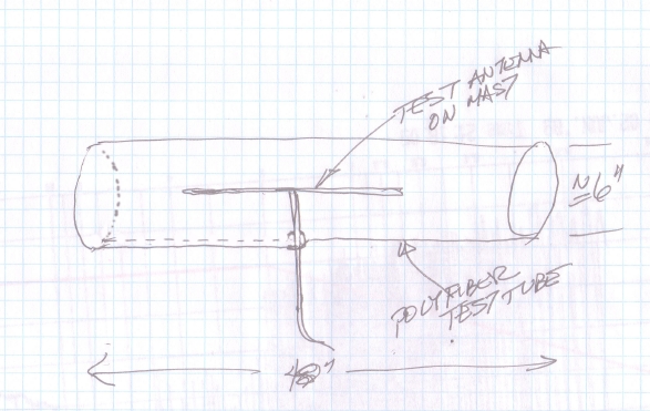

Great. I'm mulling over the geometry of a
polyfiber 'test cell' that would facilitate
relative attenuation measurements on a range
of antennas. Structure for the cell should
be RF transparent.
I'm thinking of a cylindrical tube on the
order of 6" diameter and 48" long covered
with exemplar polyfiber finished fabric.
[img]cid:.0[/img]
The tube would have a single split-cut over
half the length to a mast clearance hole in
the middle. This would allow it to be
slipped over dipole antennas covering our
range of interest. I'm thinking of tests at
130, 330, and 1000 Mhz which can be generated
and measured with equipment I have.
I wonder if a cardboard tube of the smallest practice
thickness could be used as a former. I considered
plastic DWV pipe . . . but these materials have some
degree of RF opacity. I guess we could have two
such tubes, one that's covered and one that is
not covered. That would wash out effects of the
plastic in the sandwich layers. Your thoughts
and the thoughts of others are welcome.
I'm negotiating a business arrangement
with a OBAM aircraft magazine to do a regular
flow of articles. This experiment might provide
the 'meat' for a first article .

I don't know anything about the RF aspect, but what about two 4" pvc drain pipes, one bare and one coated with poly spray? If the coating is the target variable, that would pretty well isolate it. Another easy to find source would be a cardboard shipping tube, either circular in cross section or triangular.
